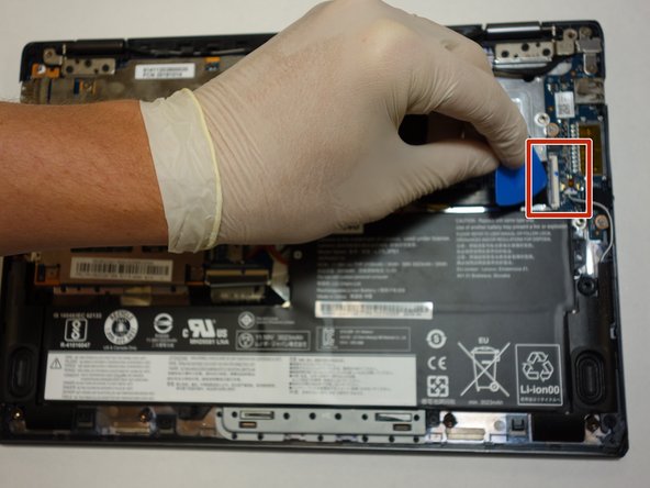

  8. Lenovo Flex 6-11IGM Motherboard Replacement, Motherboard: crwdns2935265:08crwdnd2935265:01crwdnd2935265:01crwdne2935265:0
    • Disengage the cable located above the left speaker.
    • Disengage the ribbon cable located directly above the battery using the blue pick.
    • Disengage the battery cable directly above the ribbon cable housing.
    • Disengage the CMOS battery cable located to the right of the battery cable.
    • Remove the display cable located directly above the button battery.
    • Disengage the secondary display cable located directly to the left of the display cable.

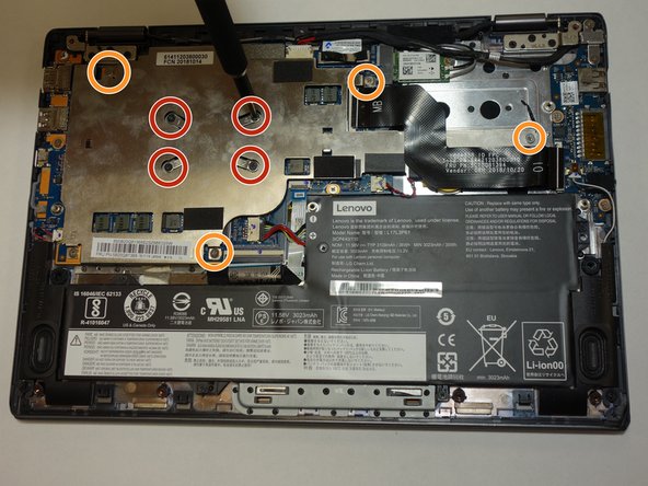

  9. Lenovo Flex 6-11IGM Motherboard Replacement: crwdns2935265:09crwdnd2935265:01crwdnd2935265:01crwdne2935265:0
    • Using a Phillips #0 screwdriver, remove the five 3.5 mm screws that secure the motherboard.
    • Using a Phillips #0 screwdriver, remove the one 3.5 mm screw that secures the Wi-Fi chip, located above the button battery.
  10. Lenovo Flex 6-11IGM Motherboard Replacement: crwdns2935265:010crwdnd2935265:01crwdnd2935265:01crwdne2935265:0
    • Remove the Wi-Fi chip located above the button battery from the motherboard.
    • Remove the motherboard from the case.
