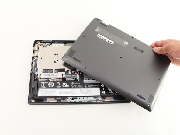

    • Flip the device over and lay it down with the underside facing upwards.
  2. Lenovo Flex 6-11IGM Motherboard Replacement: crwdns2935265:02crwdnd2935265:01crwdnd2935265:02crwdne2935265:0 Lenovo Flex 6-11IGM Motherboard Replacement: crwdns2935265:02crwdnd2935265:02crwdnd2935265:02crwdne2935265:0
    • Remove the ten screws with a Phillips #00 screwdriver.
  3. Lenovo Flex 6-11IGM Motherboard Replacement: crwdns2935265:03crwdnd2935265:01crwdnd2935265:01crwdne2935265:0
    • Using a plastic opening tool, make your way around the edge of the laptop.
  4. Lenovo Flex 6-11IGM Motherboard Replacement: crwdns2935265:04crwdnd2935265:01crwdnd2935265:02crwdne2935265:0 Lenovo Flex 6-11IGM Motherboard Replacement: crwdns2935265:04crwdnd2935265:02crwdnd2935265:02crwdne2935265:0
    • After making sure the back panel is completely free from the body, remove the back panel.

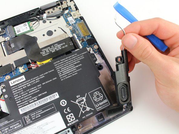

  5. Lenovo Flex 6-11IGM Motherboard Replacement, Speaker Unit: crwdns2935265:05crwdnd2935265:01crwdnd2935265:03crwdne2935265:0 Lenovo Flex 6-11IGM Motherboard Replacement, Speaker Unit: crwdns2935265:05crwdnd2935265:02crwdnd2935265:03crwdne2935265:0 Lenovo Flex 6-11IGM Motherboard Replacement, Speaker Unit: crwdns2935265:05crwdnd2935265:03crwdnd2935265:03crwdne2935265:0

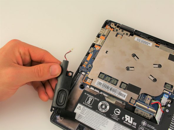

    • For the right speaker, disconnect the wire using the iFixit opening tool.
    • Pull the speaker out.
  6. Lenovo Flex 6-11IGM Motherboard Replacement: crwdns2935265:06crwdnd2935265:01crwdnd2935265:02crwdne2935265:0 Lenovo Flex 6-11IGM Motherboard Replacement: crwdns2935265:06crwdnd2935265:02crwdnd2935265:02crwdne2935265:0
    • For the speaker on the left, disconnect the wire using the iFixit opening tool.

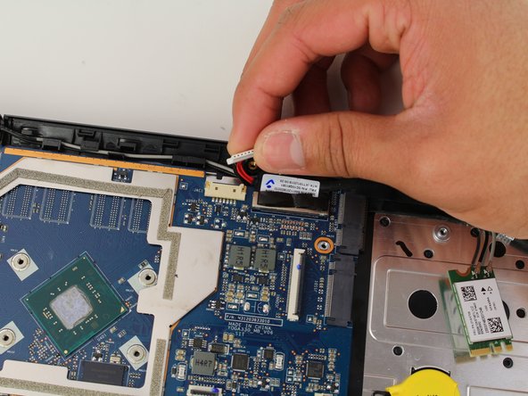

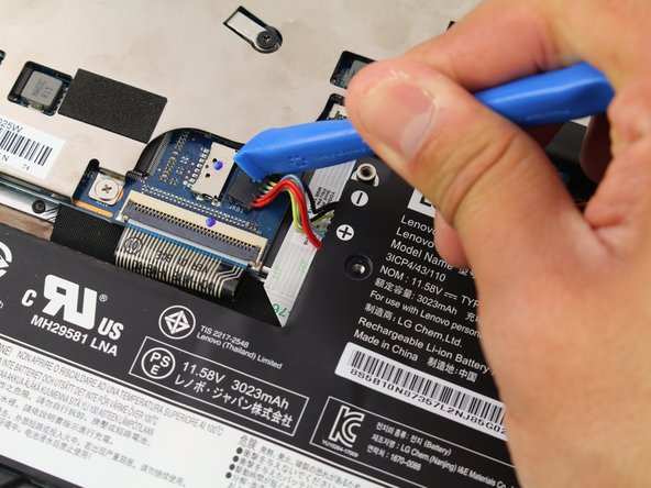

    • Pull out the multicolored connecting cables using an iFixit opening tool.
  9. Lenovo Flex 6-11IGM Motherboard Replacement: crwdns2935265:09crwdnd2935265:01crwdnd2935265:01crwdne2935265:0
    • Remove the now disconnected battery from the laptop.

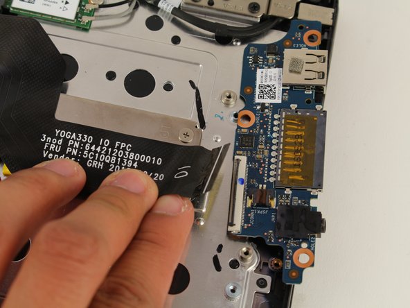

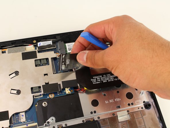

  10. Lenovo Flex 6-11IGM Motherboard Replacement, Heat Sink: crwdns2935265:010crwdnd2935265:01crwdnd2935265:03crwdne2935265:0 Lenovo Flex 6-11IGM Motherboard Replacement, Heat Sink: crwdns2935265:010crwdnd2935265:02crwdnd2935265:03crwdne2935265:0 Lenovo Flex 6-11IGM Motherboard Replacement, Heat Sink: crwdns2935265:010crwdnd2935265:03crwdnd2935265:03crwdne2935265:0

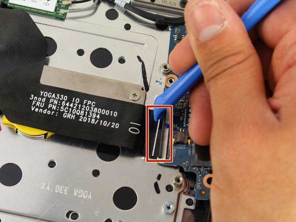

    • Disconnect the ribbon connector from both ends by disengaging the black latch and pulling it directly from its port.

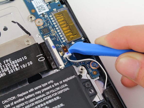

  12. Lenovo Flex 6-11IGM Motherboard Replacement, Auxiliary and USB Port: crwdns2935265:012crwdnd2935265:01crwdnd2935265:03crwdne2935265:0 Lenovo Flex 6-11IGM Motherboard Replacement, Auxiliary and USB Port: crwdns2935265:012crwdnd2935265:02crwdnd2935265:03crwdne2935265:0 Lenovo Flex 6-11IGM Motherboard Replacement, Auxiliary and USB Port: crwdns2935265:012crwdnd2935265:03crwdnd2935265:03crwdne2935265:0
    • Disconnect the ribbon connector using the iFixit opening tool tool by flipping up the black flap and pulling the ribbon out.
  13. Lenovo Flex 6-11IGM Motherboard Replacement: crwdns2935265:013crwdnd2935265:01crwdnd2935265:02crwdne2935265:0 Lenovo Flex 6-11IGM Motherboard Replacement: crwdns2935265:013crwdnd2935265:02crwdnd2935265:02crwdne2935265:0

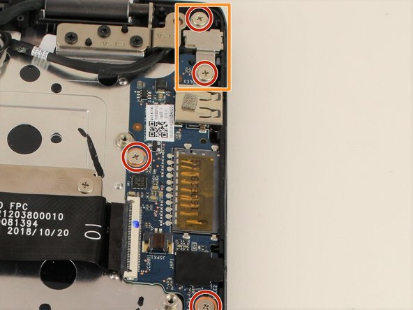

    • Take the three 3.5mm silver screws out using the Phillips #00 screwdriver.
    • Remove the protective silver shield before removing the ports.
    • Using the iFixit opening tool, insert its end underneath the ports, and pull them upwards toward you to remove them safely.

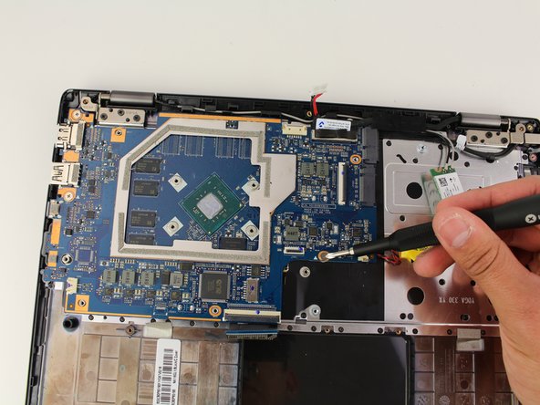

  14. Lenovo Flex 6-11IGM Motherboard Replacement, Motherboard: crwdns2935265:014crwdnd2935265:01crwdnd2935265:02crwdne2935265:0 Lenovo Flex 6-11IGM Motherboard Replacement, Motherboard: crwdns2935265:014crwdnd2935265:02crwdnd2935265:02crwdne2935265:0

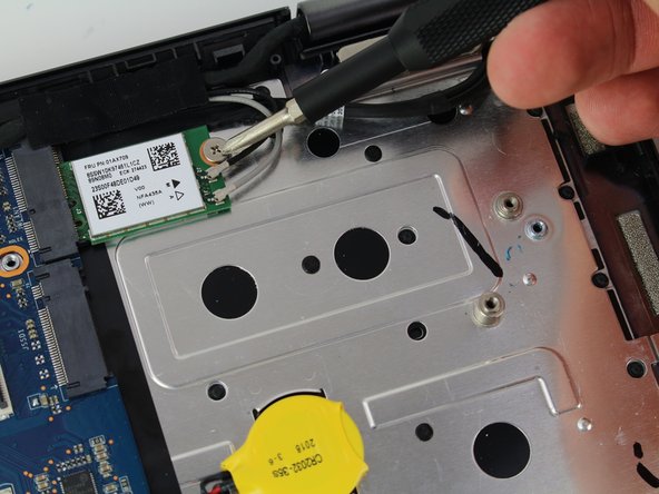

    • Unscrew the single 3.5 mm screw from the RAM card using a Phillips #00 screwdriver.
    • Unplug from motherboard.

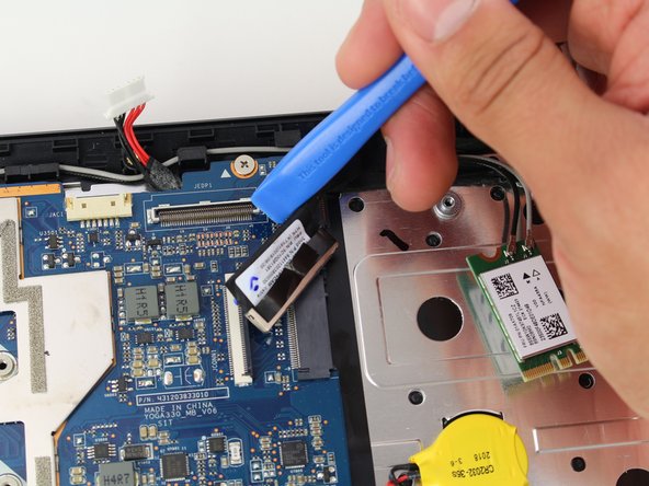

  15. Lenovo Flex 6-11IGM Motherboard Replacement: crwdns2935265:015crwdnd2935265:01crwdnd2935265:03crwdne2935265:0 Lenovo Flex 6-11IGM Motherboard Replacement: crwdns2935265:015crwdnd2935265:02crwdnd2935265:03crwdne2935265:0 Lenovo Flex 6-11IGM Motherboard Replacement: crwdns2935265:015crwdnd2935265:03crwdnd2935265:03crwdne2935265:0
    • Use an opening tool to remove the connecting cables.
  16. Lenovo Flex 6-11IGM Motherboard Replacement: crwdns2935265:016crwdnd2935265:01crwdnd2935265:02crwdne2935265:0 Lenovo Flex 6-11IGM Motherboard Replacement: crwdns2935265:016crwdnd2935265:02crwdnd2935265:02crwdne2935265:0
    • Unscrew the three 3.5 mm retaining screws from the motherboard using a Phillips #00 screwdriver.
  17. Lenovo Flex 6-11IGM Motherboard Replacement: crwdns2935265:017crwdnd2935265:01crwdnd2935265:01crwdne2935265:0
    • Pick up and remove motherboard from laptop.
