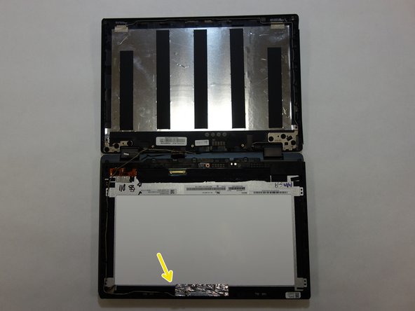

  4. Lenovo Flex 6-11IGM Display Replacement: crwdns2935265:04crwdnd2935265:01crwdnd2935265:02crwdne2935265:0 Lenovo Flex 6-11IGM Display Replacement: crwdns2935265:04crwdnd2935265:02crwdnd2935265:02crwdne2935265:0
    • Disengage the cable located at the bottom of the display.
    • Slide a plastic opening pick under the brown bar, lifting the bar up, and disengage the wire with your fingers.
    • Disengage the cable at the bottom left of the display with your fingers.
    • Disengage the cable at the top center of the display using your fingers and remove the cable from the display housing.
  5. Lenovo Flex 6-11IGM Display Replacement: crwdns2935265:05crwdnd2935265:01crwdnd2935265:01crwdne2935265:0
    • Remove the display.
