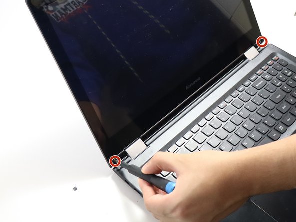

    • Use the black spudger to pry off the two rubber covers at the bottom right and left side of the laptop screen.
    • Remove the two 4.0 mm screws that were under the rubber covers using a JIS #0 screwdriver.
    • Pry off the plastic covers that you just unscrewed with the spudger.

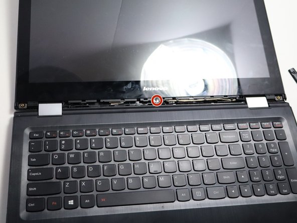

    • Pry off the middle black plastic part with the spudger. Remove the 4.0 mm screw using a JIS #0 screwdriver.

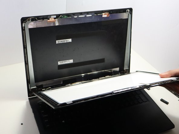

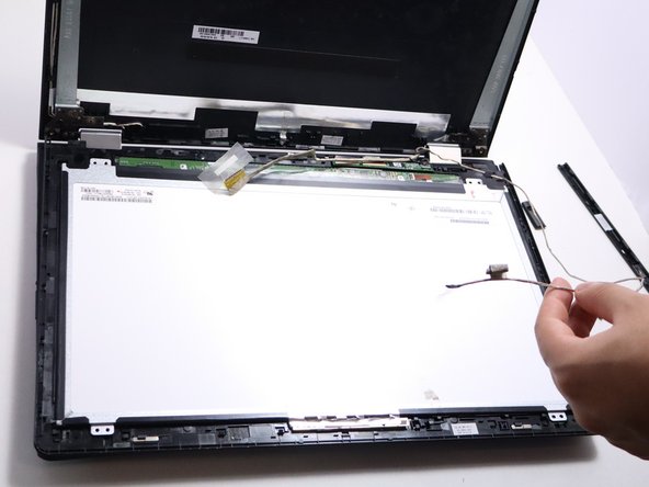

  3. Lenovo Flex 3-1580 Screen Replacement: crwdns2935265:03crwdnd2935265:01crwdnd2935265:03crwdne2935265:0 Lenovo Flex 3-1580 Screen Replacement: crwdns2935265:03crwdnd2935265:02crwdnd2935265:03crwdne2935265:0 Lenovo Flex 3-1580 Screen Replacement: crwdns2935265:03crwdnd2935265:03crwdnd2935265:03crwdne2935265:0
    • Pry off the backing of the screen with a spudger.
    • The screen will then fall off; however it will still be connected to the screen back plate like in picture 3.

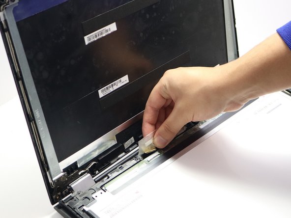

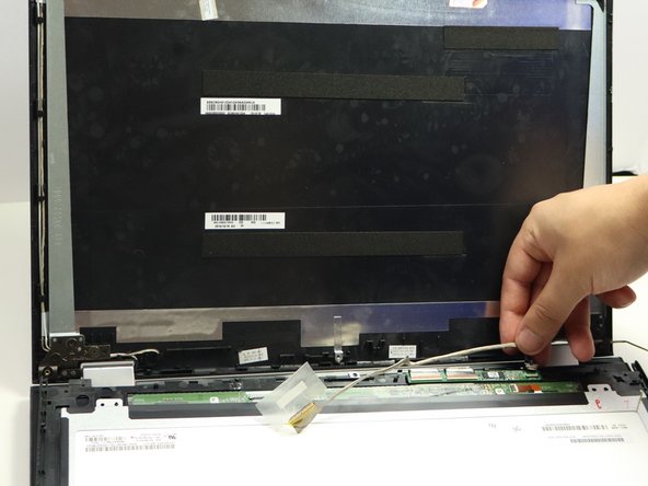

  4. Lenovo Flex 3-1580 Screen Replacement: crwdns2935265:04crwdnd2935265:01crwdnd2935265:03crwdne2935265:0 Lenovo Flex 3-1580 Screen Replacement: crwdns2935265:04crwdnd2935265:02crwdnd2935265:03crwdne2935265:0 Lenovo Flex 3-1580 Screen Replacement: crwdns2935265:04crwdnd2935265:03crwdnd2935265:03crwdne2935265:0
    • Peel off the tape and disconnect the yellow cable from the screen.
    • Follow the cable to unplug the smaller black plug in as seen in the second picture.
    • Follow the same cable all along the side of the screen and untape and disconnect the cable going into the camera.
