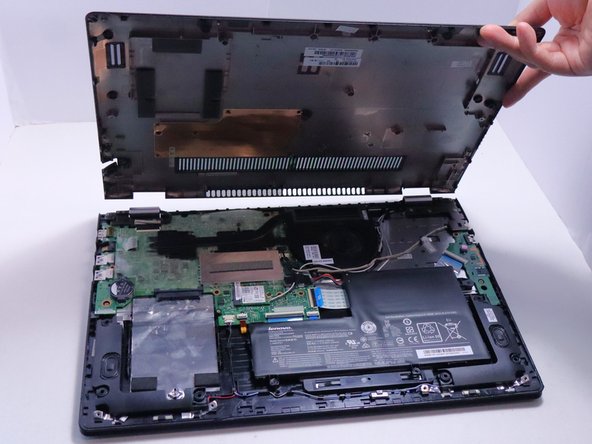

  1. Lenovo Flex 3-1580 Cooling Fan Replacement, Back Cover: crwdns2935265:01crwdnd2935265:01crwdnd2935265:01crwdne2935265:0
    • Remove eleven 6.0 mm screws from the bottom cover using a JIS #1 screwdriver.
  2. Lenovo Flex 3-1580 Cooling Fan Replacement: crwdns2935265:02crwdnd2935265:01crwdnd2935265:02crwdne2935265:0 Lenovo Flex 3-1580 Cooling Fan Replacement: crwdns2935265:02crwdnd2935265:02crwdnd2935265:02crwdne2935265:0
    • Loosen the backing cover by sliding a spudger along the edges.
    • You’ll hear and feel a pop as you loosen the edges. This lets you know the backing is loosening up.
    • Remove the bottom cover from the laptop.

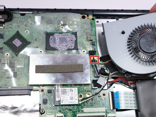

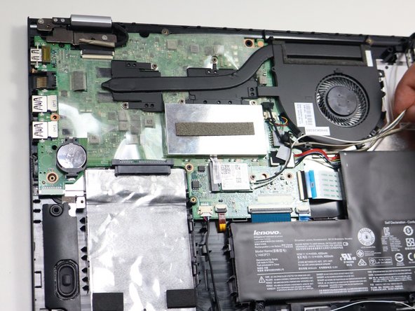

  3. Lenovo Flex 3-1580 Cooling Fan Replacement, Cooling Fan: crwdns2935265:03crwdnd2935265:01crwdnd2935265:02crwdne2935265:0 Lenovo Flex 3-1580 Cooling Fan Replacement, Cooling Fan: crwdns2935265:03crwdnd2935265:02crwdnd2935265:02crwdne2935265:0
    • Loosen the five 6.0 mm screws with a JIS #1 screwdriver.
    • Release the cables from the guides.

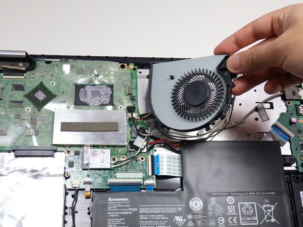

  4. Lenovo Flex 3-1580 Cooling Fan Replacement: crwdns2935265:04crwdnd2935265:01crwdnd2935265:03crwdne2935265:0 Lenovo Flex 3-1580 Cooling Fan Replacement: crwdns2935265:04crwdnd2935265:02crwdnd2935265:03crwdne2935265:0 Lenovo Flex 3-1580 Cooling Fan Replacement: crwdns2935265:04crwdnd2935265:03crwdnd2935265:03crwdne2935265:0
    • Remove the fan and heat sink by lifting upwards.
    • Unplug the fan connector pulling downwards.
    • Before installing a new fan, apply a pea-sized amount of thermal paste the the CPU.
    • When reinstalling, make sure the cables are not subjected to any tension. The tension can cause the cables to be damaged by the cable guides.
