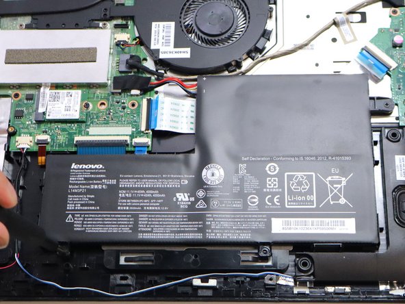

  3. Lenovo Flex 3-1580 Battery Replacement, Battery: crwdns2935265:03crwdnd2935265:01crwdnd2935265:02crwdne2935265:0 Lenovo Flex 3-1580 Battery Replacement, Battery: crwdns2935265:03crwdnd2935265:02crwdnd2935265:02crwdne2935265:0
    • Remove the two 2.5 screws from the battery using a JIS #0 screwdriver.

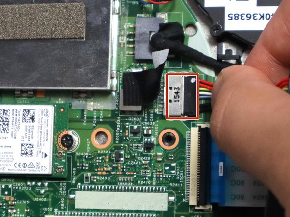

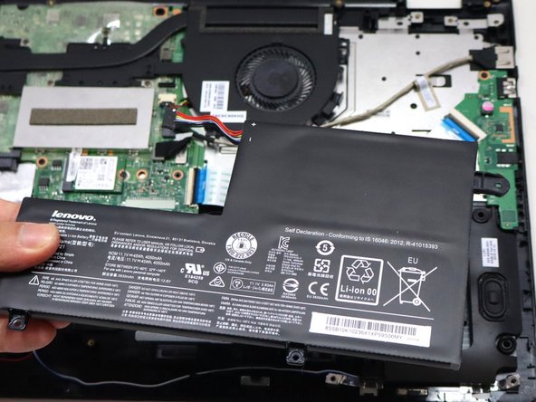

  4. Lenovo Flex 3-1580 Battery Replacement: crwdns2935265:04crwdnd2935265:01crwdnd2935265:03crwdne2935265:0 Lenovo Flex 3-1580 Battery Replacement: crwdns2935265:04crwdnd2935265:02crwdnd2935265:03crwdne2935265:0 Lenovo Flex 3-1580 Battery Replacement: crwdns2935265:04crwdnd2935265:03crwdnd2935265:03crwdne2935265:0
    • Disconnect the colorful cables at the top left of the battery from the motherboard.
    • With the battery unplugged, pull up from the top side and then slide out upwards.
