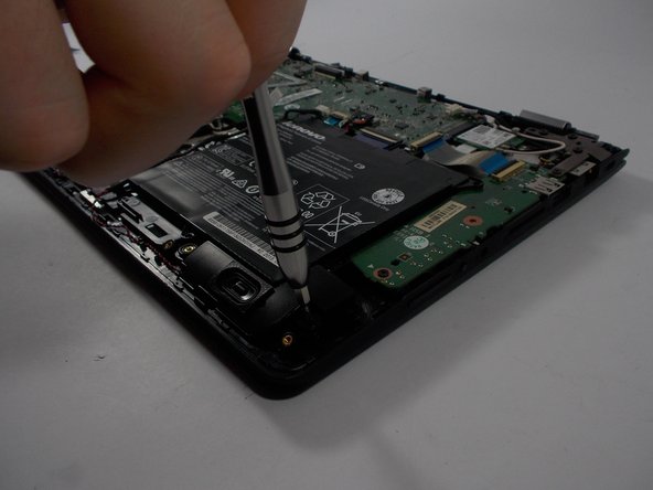

  5. Lenovo Flex 3-1120 Speakers Replacement, Speakers: crwdns2935265:05crwdnd2935265:01crwdnd2935265:01crwdne2935265:0
    • Locate the speakers at the bottom left and right corners of the computer.
  6. Lenovo Flex 3-1120 Speakers Replacement: crwdns2935265:06crwdnd2935265:01crwdnd2935265:02crwdne2935265:0 Lenovo Flex 3-1120 Speakers Replacement: crwdns2935265:06crwdnd2935265:02crwdnd2935265:02crwdne2935265:0
    • Locate the two 1mm Phillips head screws on both speakers.
    • Remove both screws from each speaker.

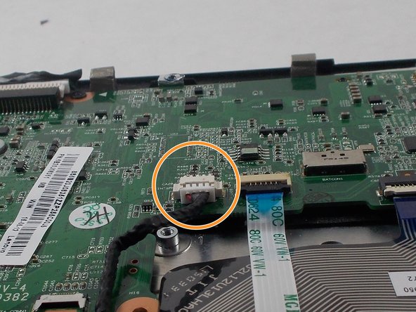

  7. Lenovo Flex 3-1120 Speakers Replacement: crwdns2935265:07crwdnd2935265:01crwdnd2935265:02crwdne2935265:0 Lenovo Flex 3-1120 Speakers Replacement: crwdns2935265:07crwdnd2935265:02crwdnd2935265:02crwdne2935265:0
    • Locate where the two speaker wires join at the center of the computer.
    • Follow the wires directly upward to where they connect into the motherboard.
  8. Lenovo Flex 3-1120 Speakers Replacement: crwdns2935265:08crwdnd2935265:01crwdnd2935265:01crwdne2935265:0
    • Using the spudger, pull the wire down and away from the motherboard to disconnect it.
