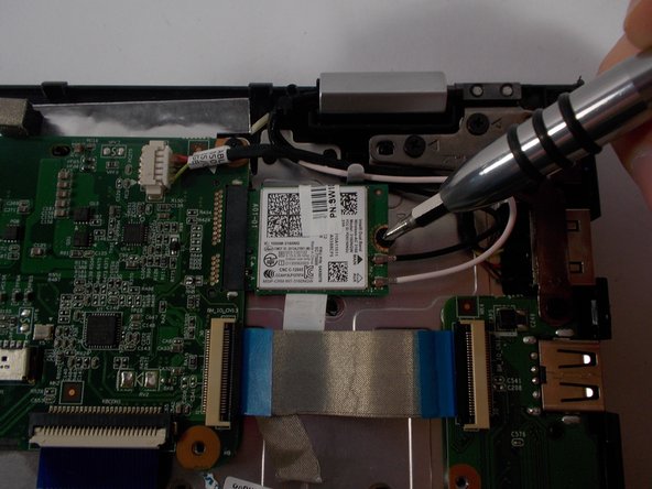

  5. Lenovo Flex 3-1120 Network Card Replacement, Network Card: crwdns2935265:05crwdnd2935265:01crwdnd2935265:01crwdne2935265:0
    • Locate the network card on the top right of the computer.
  6. Lenovo Flex 3-1120 Network Card Replacement: crwdns2935265:06crwdnd2935265:01crwdnd2935265:02crwdne2935265:0 Lenovo Flex 3-1120 Network Card Replacement: crwdns2935265:06crwdnd2935265:02crwdnd2935265:02crwdne2935265:0
    • Locate the single 3.5mm Phillips head screw on the right edge of the network card.
    • Remove the single screw with a size 0 Phillips screwdriver.
  7. Lenovo Flex 3-1120 Network Card Replacement: crwdns2935265:07crwdnd2935265:01crwdnd2935265:01crwdne2935265:0
    • Slide the network card out to the right to remove it from the motherboard.

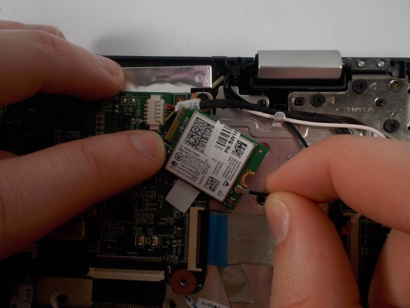

  8. Lenovo Flex 3-1120 Network Card Replacement: crwdns2935265:08crwdnd2935265:01crwdnd2935265:02crwdne2935265:0 Lenovo Flex 3-1120 Network Card Replacement: crwdns2935265:08crwdnd2935265:02crwdnd2935265:02crwdne2935265:0
    • Locate the black and white antenna wires that are connected to the right edge of the network card.
    • Wiggle and pull upward on the two antenna cords connecting to the card to remove them.
