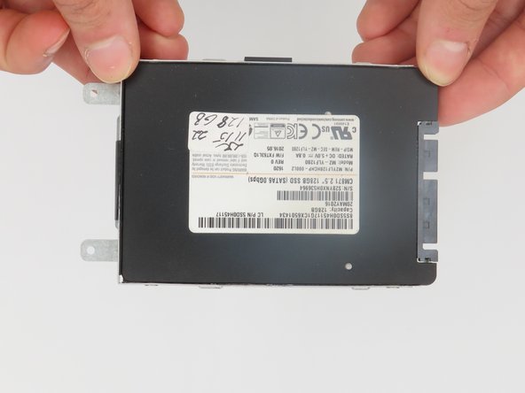

    • Begin by taking the back plate off of your device.
    • Using a Phillips head screw driver, take out the highlighted screws for your device.
  2. Lenovo Flex 2-15 SSD Replacement: crwdns2935265:02crwdnd2935265:01crwdnd2935265:02crwdne2935265:0 Lenovo Flex 2-15 SSD Replacement: crwdns2935265:02crwdnd2935265:02crwdnd2935265:02crwdne2935265:0
    • Locate the SSD bay for your device via the highlighted portion.
  3. Lenovo Flex 2-15 SSD Replacement: crwdns2935265:03crwdnd2935265:01crwdnd2935265:01crwdne2935265:0
    • Using the pull tab shown here, gently take the SSD out of its highlighted slot.
  4. Lenovo Flex 2-15 SSD Replacement: crwdns2935265:04crwdnd2935265:01crwdnd2935265:02crwdne2935265:0 Lenovo Flex 2-15 SSD Replacement: crwdns2935265:04crwdnd2935265:02crwdnd2935265:02crwdne2935265:0
    • We will need to use a Phillips screwdriver to take the SSD out of its bay.
