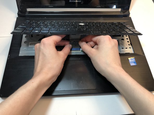

    • Using a prying tool, carefully lift up the keyboard.
  3. Lenovo Flex 2-14 Hard Drive Replacement: crwdns2935265:03crwdnd2935265:01crwdnd2935265:03crwdne2935265:0 Lenovo Flex 2-14 Hard Drive Replacement: crwdns2935265:03crwdnd2935265:02crwdnd2935265:03crwdne2935265:0 Lenovo Flex 2-14 Hard Drive Replacement: crwdns2935265:03crwdnd2935265:03crwdnd2935265:03crwdne2935265:0

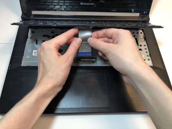

    • Take out the keyboard by disconnecting the cable.

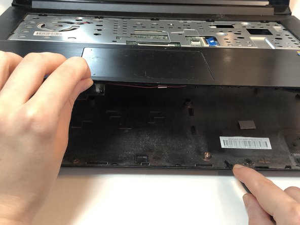

    • Separate the top and bottom panels of the laptop using a prying tool.
    • Slide the prying tool along the edges of the laptop until the bottom panel is completely separated.
    • Remove the back cover of the laptop once you have finished prying it open.

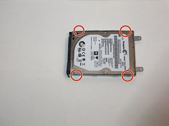

    • Take out the adapter containing the hard drive from the laptop.
    • Remove all four 4mm Phillips screws from the adapter.

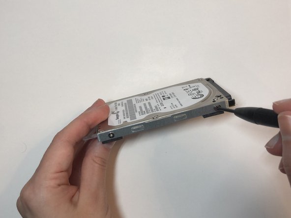

    • Remove the hard drive from the adapter.
    • Insert the new hard drive into the adapter.
  9. Lenovo Flex 2-14 Hard Drive Replacement: crwdns2935265:09crwdnd2935265:01crwdnd2935265:03crwdne2935265:0 Lenovo Flex 2-14 Hard Drive Replacement: crwdns2935265:09crwdnd2935265:02crwdnd2935265:03crwdne2935265:0 Lenovo Flex 2-14 Hard Drive Replacement: crwdns2935265:09crwdnd2935265:03crwdnd2935265:03crwdne2935265:0
    • Put all four 4mm Phillips screws back into the adapter with the hard drive, in order to hold it in place.
    • Put the adapter back in and reassemble the laptop.
