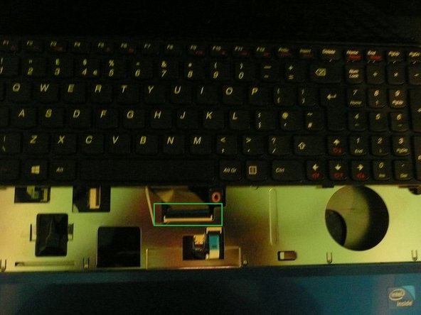

    • Remove the 3 Screws holding the Keyboard to the Laptop (Boxed In Red).
    • Turn the Laptop over and open the lid to reveal the Keyboard.
    • Using a Safe open tool or any prying tool begin to pry up the Keyboard from all sides.
    • Once the Keyboard is loose GENTLY push it towards the LCD without lifting it up more than three inches.
    • Pull up on the tab holding the Keyboard Flex in position (Boxed In Green) and remove the Keyboard.
    • Close the lid and turn the Laptop back upside down.
    • Remove all the screws boxed in red.
    • Remove the 2 remaining screws boxed in Blue.
