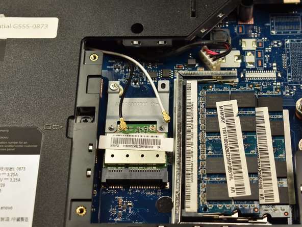

  3. Lenovo Essential G555-0873 Wireless Card Replacement, Wireless Card: crwdns2935265:03crwdnd2935265:01crwdnd2935265:02crwdne2935265:0 Lenovo Essential G555-0873 Wireless Card Replacement, Wireless Card: crwdns2935265:03crwdnd2935265:02crwdnd2935265:02crwdne2935265:0
    • Gently unplug the black and white wires shown in the picture from the wireless card.

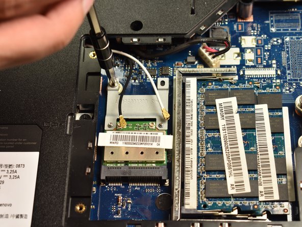

  4. Lenovo Essential G555-0873 Wireless Card Replacement: crwdns2935265:04crwdnd2935265:01crwdnd2935265:02crwdne2935265:0 Lenovo Essential G555-0873 Wireless Card Replacement: crwdns2935265:04crwdnd2935265:02crwdnd2935265:02crwdne2935265:0
    • Unscrew the 3.6 mm screw shown in the picture.
