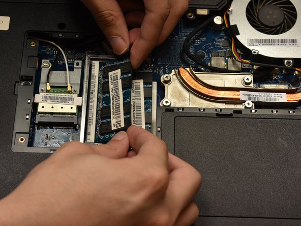

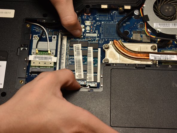

  3. Lenovo Essential G555-0873 RAM Replacement, RAM: crwdns2935265:03crwdnd2935265:01crwdnd2935265:03crwdne2935265:0 Lenovo Essential G555-0873 RAM Replacement, RAM: crwdns2935265:03crwdnd2935265:02crwdnd2935265:03crwdne2935265:0 Lenovo Essential G555-0873 RAM Replacement, RAM: crwdns2935265:03crwdnd2935265:03crwdnd2935265:03crwdne2935265:0
    • Push apart hinges shown in picture until RAM pushes itself up to approximately a 30 degree angle.
  4. Lenovo Essential G555-0873 RAM Replacement: crwdns2935265:04crwdnd2935265:01crwdnd2935265:01crwdne2935265:0
    • Pull the RAM stick out of its socket.
  5. Lenovo Essential G555-0873 RAM Replacement: crwdns2935265:05crwdnd2935265:01crwdnd2935265:01crwdne2935265:0
    • Push apart hinges of lower RAM stick until it pops up to a similar angle.
  6. Lenovo Essential G555-0873 RAM Replacement: crwdns2935265:06crwdnd2935265:01crwdnd2935265:01crwdne2935265:0
    • Pull out second RAM stick in the same way as the first.

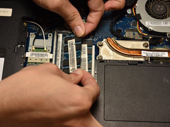

  7. Lenovo Essential G555-0873 RAM Replacement: crwdns2935265:07crwdnd2935265:01crwdnd2935265:02crwdne2935265:0 Lenovo Essential G555-0873 RAM Replacement: crwdns2935265:07crwdnd2935265:02crwdnd2935265:02crwdne2935265:0
    • Push RAM sticks in diagonally, then push down and snap it in with hinges.
    • Make sure that the RAM stick is aligned with the notch on the port when inserting it.
