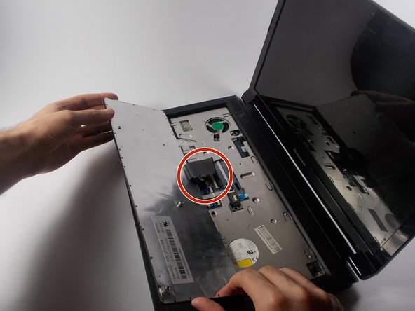

    3. Lenovo Essential B570 Keyboard Replacement: crwdns2935265:07crwdnd2935265:01crwdnd2935265:02crwdne2935265:0 Lenovo Essential B570 Keyboard Replacement: crwdns2935265:07crwdnd2935265:02crwdnd2935265:02crwdne2935265:0
      • Carefully lift the keyboard.
      • The keyboard is still connected to the laptop. Lift it slowly.
      • Turn over the keyboard to locate the keyboards ribbon cable.

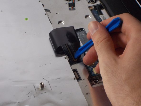

    4. Lenovo Essential B570 Keyboard Replacement: crwdns2935265:08crwdnd2935265:01crwdnd2935265:02crwdne2935265:0 Lenovo Essential B570 Keyboard Replacement: crwdns2935265:08crwdnd2935265:02crwdnd2935265:02crwdne2935265:0
      • Use the plastic opening tool to lift open the ribbon connector that is holding the ribbon cable in its slot.

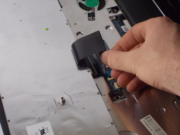

    5. Lenovo Essential B570 Keyboard Replacement: crwdns2935265:09crwdnd2935265:01crwdnd2935265:02crwdne2935265:0 Lenovo Essential B570 Keyboard Replacement: crwdns2935265:09crwdnd2935265:02crwdnd2935265:02crwdne2935265:0
      • Remove the cable from its slot.
      • If the cable does not come out easily, ensure that the black ribbon has been completely released.
