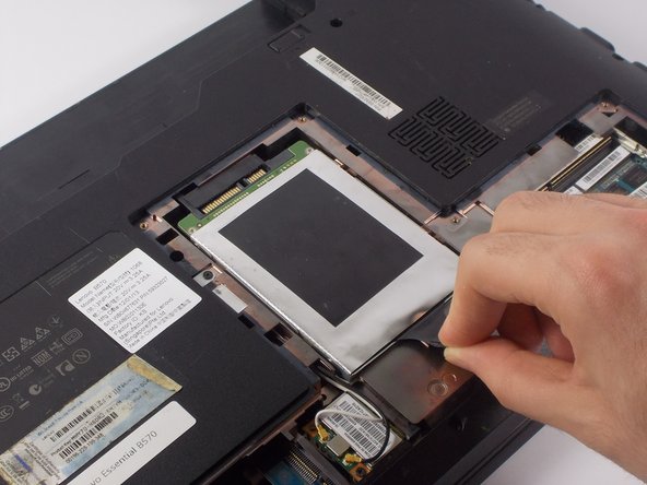

  5. Lenovo Essential B570 Hard Drive Replacement, Hard Drive: crwdns2935265:05crwdnd2935265:01crwdnd2935265:03crwdne2935265:0 Lenovo Essential B570 Hard Drive Replacement, Hard Drive: crwdns2935265:05crwdnd2935265:02crwdnd2935265:03crwdne2935265:0 Lenovo Essential B570 Hard Drive Replacement, Hard Drive: crwdns2935265:05crwdnd2935265:03crwdnd2935265:03crwdne2935265:0
    • Pull the Hard Drive out of its socket.
    • Lift the tab upwards to remove the hard drive.
    • If you cannot pull the hard drive out of its socket, there is a possibility that there is a 4mm Phillips #1 screw securing it. Locate it and remove it before continuing. It is in very close proximity to the black tab.
