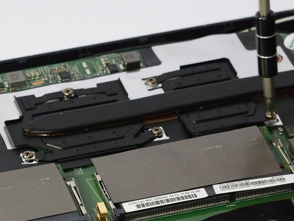

  4. Lenovo Edge 15 Fan Replacement: crwdns2935265:04crwdnd2935265:01crwdnd2935265:02crwdne2935265:0 Lenovo Edge 15 Fan Replacement: crwdns2935265:04crwdnd2935265:02crwdnd2935265:02crwdne2935265:0
    • Remove the five M2 x 4.0 mm screws from the heat sink with a Phillips #0 screwdriver.
  5. Lenovo Edge 15 Fan Replacement: crwdns2935265:05crwdnd2935265:01crwdnd2935265:01crwdne2935265:0
    • Gently lift the fan away from the computer.
