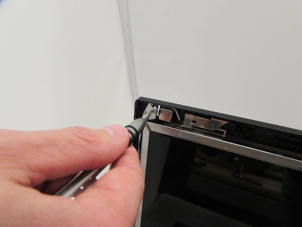

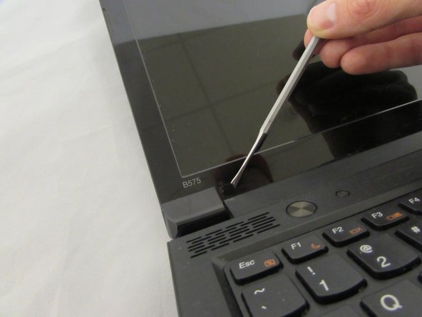

    • Remove both screw covers from the bottom of screen bezel using a plastic spudger. The screws underneath will now be exposed
  5. Lenovo B575-1450 Display Panel  Replacement: crwdns2935265:05crwdnd2935265:01crwdnd2935265:01crwdne2935265:0
    • Using the Phillips #0 Screwdriver, remove the two 4.3 mm screws holding the display to the front bezel.

    • Separate the front bezel from the display panel using the plastic opening tool by gently prying around the edges and removing it.

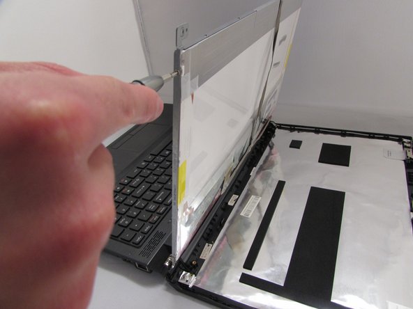

    • Using the Phillips #0 Screwdriver, remove the six 4.3 mm screws that connect display screen to the rear bezel.
    • There are two screws in the bottom left and right corners of the frame.
  9. Lenovo B575-1450 Display Panel  Replacement: crwdns2935265:09crwdnd2935265:01crwdnd2935265:02crwdne2935265:0 Lenovo B575-1450 Display Panel  Replacement: crwdns2935265:09crwdnd2935265:02crwdnd2935265:02crwdne2935265:0

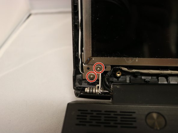

    • Using the Phillips #0 Screwdriver, remove the four 2.9 mm screws from each side of the bracket that holds the display panel in place.

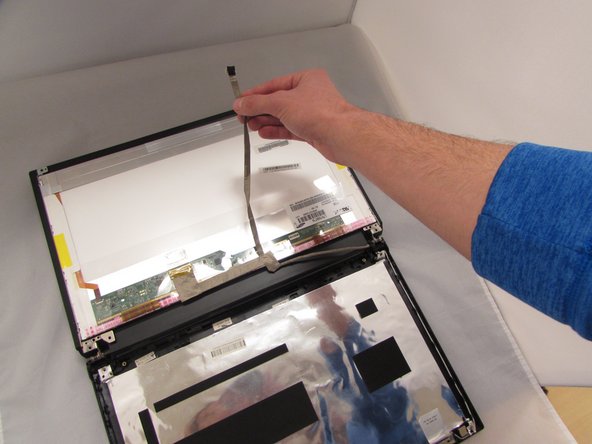

    • Lay display panel face down on the keyboard.
    • Peel back the flat wire that has the camera's ZIF connector until it is loose from the back of the display.
    • Carefully peel of the clear adhesive tape attached to the primary display ZIF connector using a plastic spudger.
  11. Lenovo B575-1450 Display Panel  Replacement: crwdns2935265:011crwdnd2935265:01crwdnd2935265:02crwdne2935265:0 Lenovo B575-1450 Display Panel  Replacement: crwdns2935265:011crwdnd2935265:02crwdnd2935265:02crwdne2935265:0
    • Place the metal tweezer tips between the ZIF connector and the wire-to-board connection.
    • Carefully separate ZIF wire-to-board connection by pulling metal tweezers in a downward motion.
    • Pull up on flat wire until display is completely disconnected.
    • Be very careful when separating ZIF connections . The ends of the ZIF wire connectors are delicate and can break easily.
