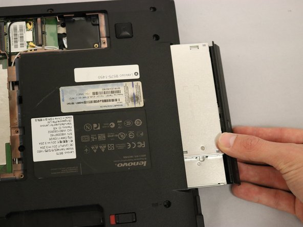

    • Push the right-hand switch outward into the "unlocked" position.
  3. Lenovo B575-1450 CD-ROM Drive Replacement: crwdns2935265:03crwdnd2935265:01crwdnd2935265:03crwdne2935265:0 Lenovo B575-1450 CD-ROM Drive Replacement: crwdns2935265:03crwdnd2935265:02crwdnd2935265:03crwdne2935265:0 Lenovo B575-1450 CD-ROM Drive Replacement: crwdns2935265:03crwdnd2935265:03crwdnd2935265:03crwdne2935265:0
    • While holding the battery, use your other hand to push the left clip to the left and pull the battery out.
  4. Lenovo B575-1450 CD-ROM Drive Replacement, Back Panel: crwdns2935265:04crwdnd2935265:01crwdnd2935265:02crwdne2935265:0 Lenovo B575-1450 CD-ROM Drive Replacement, Back Panel: crwdns2935265:04crwdnd2935265:02crwdnd2935265:02crwdne2935265:0
    • The screws are captive to the back panel so they are not to be removed.
    • Using the Phillips #00 Screwdriver, Loosen the five 5.4 mm screws around the back panel from the laptop.
  5. Lenovo B575-1450 CD-ROM Drive Replacement: crwdns2935265:05crwdnd2935265:01crwdnd2935265:01crwdne2935265:0
    • Using a plastic opening tool, pry the back panel from the laptop.
  6. Lenovo B575-1450 CD-ROM Drive Replacement: crwdns2935265:06crwdnd2935265:01crwdnd2935265:01crwdne2935265:0
    • Pull the panel outward from the rest of the laptop. The inside of the laptop will be exposed. From here you can access the CD-ROM drive, hard drive, and Keyboard.
  7. Lenovo B575-1450 CD-ROM Drive Replacement, CD-ROM Drive: crwdns2935265:07crwdnd2935265:01crwdnd2935265:02crwdne2935265:0 Lenovo B575-1450 CD-ROM Drive Replacement, CD-ROM Drive: crwdns2935265:07crwdnd2935265:02crwdnd2935265:02crwdne2935265:0
    • Using the Phillips #00 Screwdriver, remove the 3.4 mm screw from the CD-ROM bracket.
    • This unlocks the CD-ROM drive from the computer
  8. Lenovo B575-1450 CD-ROM Drive Replacement: crwdns2935265:08crwdnd2935265:01crwdnd2935265:02crwdne2935265:0 Lenovo B575-1450 CD-ROM Drive Replacement: crwdns2935265:08crwdnd2935265:02crwdnd2935265:02crwdne2935265:0
    • Pry CD-ROM drive from laptop using a plastic opening tool.
    • Pull the CD-ROM drive the rest of the way out.
