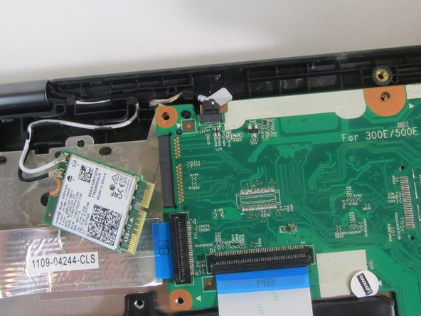

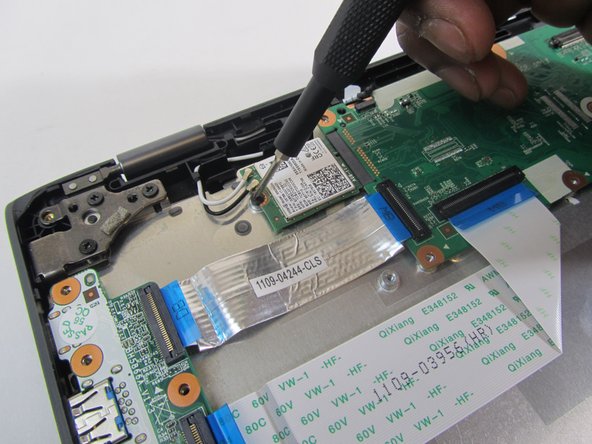

    • Remove the single 2 mm screw from the Wi-Fi card using a Phillips #00 screwdriver.
  8. Lenovo 500e Chromebook 2nd Gen Wi-Fi Card Replacement: crwdns2935265:08crwdnd2935265:01crwdnd2935265:02crwdne2935265:0 Lenovo 500e Chromebook 2nd Gen Wi-Fi Card Replacement: crwdns2935265:08crwdnd2935265:02crwdnd2935265:02crwdne2935265:0
    • Detach the Wi-Fi card from the motherboard using an iFixit opening tool.

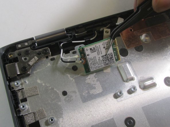

  9. Lenovo 500e Chromebook 2nd Gen Wi-Fi Card Replacement: crwdns2935265:09crwdnd2935265:01crwdnd2935265:02crwdne2935265:0 Lenovo 500e Chromebook 2nd Gen Wi-Fi Card Replacement: crwdns2935265:09crwdnd2935265:02crwdnd2935265:02crwdne2935265:0
    • Using tweezers, disconnect the two wires from the Wi-Fi card.
    • Remove the Wi-Fi card from the laptop.
