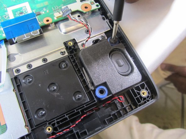

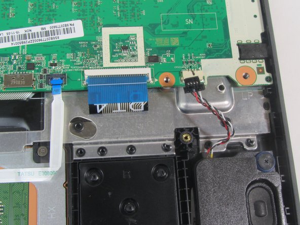

  7. Lenovo 500e Chromebook 2nd Gen Speakers Replacement, Speakers: crwdns2935265:07crwdnd2935265:01crwdnd2935265:02crwdne2935265:0 Lenovo 500e Chromebook 2nd Gen Speakers Replacement, Speakers: crwdns2935265:07crwdnd2935265:02crwdnd2935265:02crwdne2935265:0
    • Remove the two 4 mm screws (one on each speaker) using a Phillips #00 screwdriver.
  8. Lenovo 500e Chromebook 2nd Gen Speakers Replacement: crwdns2935265:08crwdnd2935265:01crwdnd2935265:02crwdne2935265:0 Lenovo 500e Chromebook 2nd Gen Speakers Replacement: crwdns2935265:08crwdnd2935265:02crwdnd2935265:02crwdne2935265:0
    • Use the iFixit opening tool to detach the right speaker cable from the motherboard.
  9. Lenovo 500e Chromebook 2nd Gen Speakers Replacement: crwdns2935265:09crwdnd2935265:01crwdnd2935265:01crwdne2935265:0
    • Remove both speakers by gently pulling them out.
