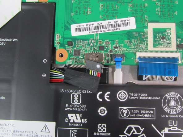

  4. Lenovo 500e Chromebook 2nd Gen Keyboard Replacement, Battery: crwdns2935265:04crwdnd2935265:01crwdnd2935265:01crwdne2935265:0
    • Remove the four 4 mm Phillips #00 screws holding the battery in.
  5. Lenovo 500e Chromebook 2nd Gen Keyboard Replacement: crwdns2935265:05crwdnd2935265:01crwdnd2935265:02crwdne2935265:0 Lenovo 500e Chromebook 2nd Gen Keyboard Replacement: crwdns2935265:05crwdnd2935265:02crwdnd2935265:02crwdne2935265:0
    • Use the iFixit opening tool to unplug the battery from the motherboard.
    • Potential for device damage: Make sure to be gentle while removing the wire.
  6. Lenovo 500e Chromebook 2nd Gen Keyboard Replacement: crwdns2935265:06crwdnd2935265:01crwdnd2935265:01crwdne2935265:0
    • Remove the battery from the laptop.

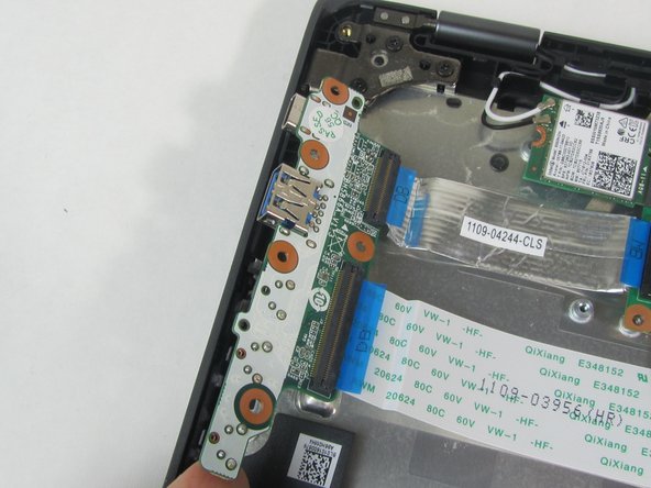

    • Remove the nine 4 mm screws from the motherboard using a Phillips #00 screwdriver.
  9. Lenovo 500e Chromebook 2nd Gen Keyboard Replacement: crwdns2935265:09crwdnd2935265:01crwdnd2935265:02crwdne2935265:0 Lenovo 500e Chromebook 2nd Gen Keyboard Replacement: crwdns2935265:09crwdnd2935265:02crwdnd2935265:02crwdne2935265:0

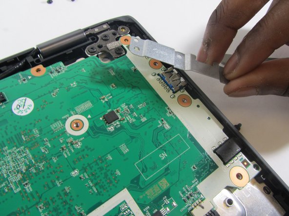

    • Gently remove the USB port from the side housing using an iFixit opening tool.
  10. Lenovo 500e Chromebook 2nd Gen Keyboard Replacement: crwdns2935265:010crwdnd2935265:01crwdnd2935265:02crwdne2935265:0 Lenovo 500e Chromebook 2nd Gen Keyboard Replacement: crwdns2935265:010crwdnd2935265:02crwdnd2935265:02crwdne2935265:0
    • Gently peel the metal strip away from the metal backing.

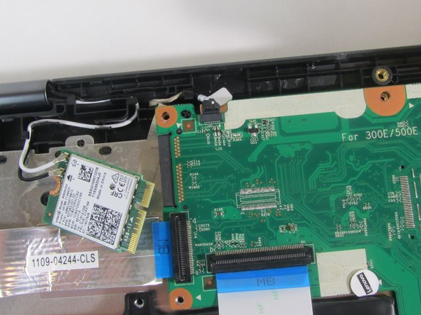

  11. Lenovo 500e Chromebook 2nd Gen Keyboard Replacement: crwdns2935265:011crwdnd2935265:01crwdnd2935265:01crwdne2935265:0

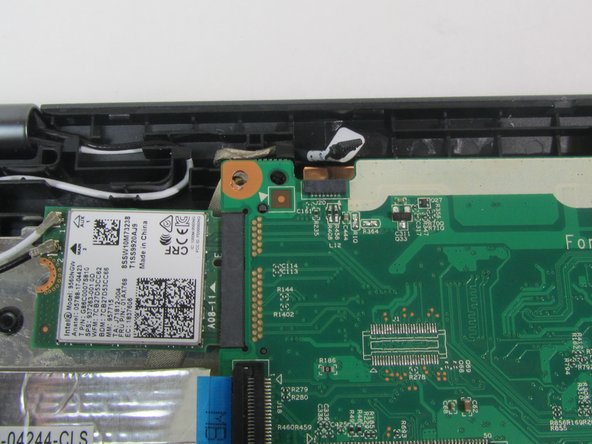

    • Remove the single 3 mm screw that holds the Wi-Fi card in place using a Phillips #00 screwdriver.
  12. Lenovo 500e Chromebook 2nd Gen Keyboard Replacement: crwdns2935265:012crwdnd2935265:01crwdnd2935265:02crwdne2935265:0 Lenovo 500e Chromebook 2nd Gen Keyboard Replacement: crwdns2935265:012crwdnd2935265:02crwdnd2935265:02crwdne2935265:0
    • Disconnect the Wi-Fi card from the motherboard using an iFixit opening tool.

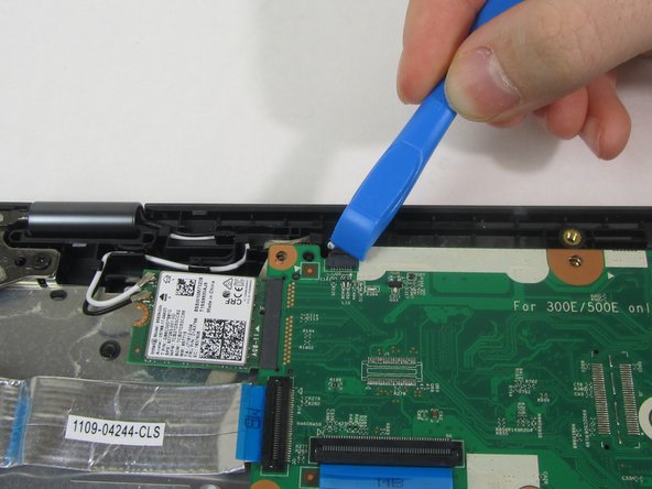

    • Using an iFixit opening tool, disconnect the camera cable.
    • Potential for device damage: Be gentle while removing the wire.

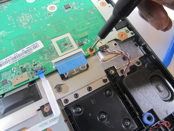

  14. Lenovo 500e Chromebook 2nd Gen Keyboard Replacement: crwdns2935265:014crwdnd2935265:01crwdnd2935265:02crwdne2935265:0 Lenovo 500e Chromebook 2nd Gen Keyboard Replacement: crwdns2935265:014crwdnd2935265:02crwdnd2935265:02crwdne2935265:0
    • Using an iFixit opening tool, detach the speaker wiring from the motherboard.
    • Set speakers aside for reinstallation.

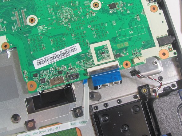

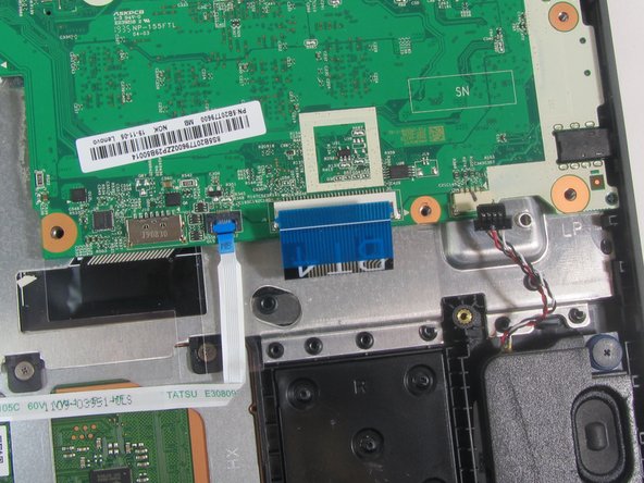

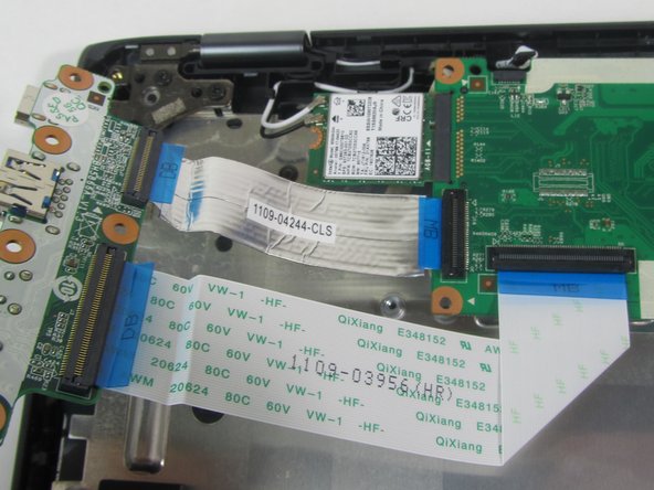

  15. Lenovo 500e Chromebook 2nd Gen Keyboard Replacement: crwdns2935265:015crwdnd2935265:01crwdnd2935265:02crwdne2935265:0 Lenovo 500e Chromebook 2nd Gen Keyboard Replacement: crwdns2935265:015crwdnd2935265:02crwdnd2935265:02crwdne2935265:0
    • Using an iFixit opening tool, detach the track pad connector from the motherboard.
    • Potential for device damage: Be gentle while detaching the connector.

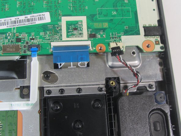

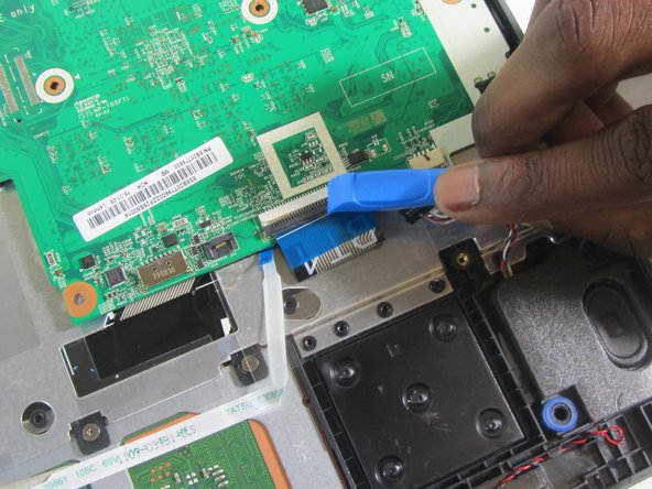

  16. Lenovo 500e Chromebook 2nd Gen Keyboard Replacement: crwdns2935265:016crwdnd2935265:01crwdnd2935265:03crwdne2935265:0 Lenovo 500e Chromebook 2nd Gen Keyboard Replacement: crwdns2935265:016crwdnd2935265:02crwdnd2935265:03crwdne2935265:0 Lenovo 500e Chromebook 2nd Gen Keyboard Replacement: crwdns2935265:016crwdnd2935265:03crwdnd2935265:03crwdne2935265:0
    • Using an iFixit opening tool, detach the keyboard cable from the motherboard.
    • Potential for device damage: Be gentle when detaching the cable.

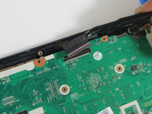

  17. Lenovo 500e Chromebook 2nd Gen Keyboard Replacement: crwdns2935265:017crwdnd2935265:01crwdnd2935265:02crwdne2935265:0 Lenovo 500e Chromebook 2nd Gen Keyboard Replacement: crwdns2935265:017crwdnd2935265:02crwdnd2935265:02crwdne2935265:0
    • Using tweezers, disconnect the black cable from the motherboard.
    • Potential for device damage: Be gentle while detaching the cable.

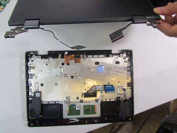

  19. Lenovo 500e Chromebook 2nd Gen Keyboard Replacement, Keyboard: crwdns2935265:019crwdnd2935265:01crwdnd2935265:01crwdne2935265:0
    • Remove the three 5 mm screws (six total) from each hinge using a Phillips #0 screwdriver.
  20. Lenovo 500e Chromebook 2nd Gen Keyboard Replacement: crwdns2935265:020crwdnd2935265:01crwdnd2935265:02crwdne2935265:0 Lenovo 500e Chromebook 2nd Gen Keyboard Replacement: crwdns2935265:020crwdnd2935265:02crwdnd2935265:02crwdne2935265:0
    • Gently open the laptop screen and it will separate from the keyboard.
