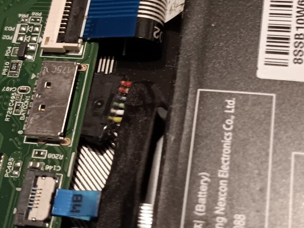

  3. Lenovo 300e Windows 2nd Gen Battery Replacement, Unplug the battery.: crwdns2935265:03crwdnd2935265:01crwdnd2935265:02crwdne2935265:0 Lenovo 300e Windows 2nd Gen Battery Replacement, Unplug the battery.: crwdns2935265:03crwdnd2935265:02crwdnd2935265:02crwdne2935265:0
    • Be sure to not puncture the battery. It may explode or catch fire if it is mistreated. Proceed with caution. Especially if your battery is puffy!
    • Carefully unplug the battery from the device.
  4. Lenovo 300e Windows 2nd Gen Battery Replacement, Remove the battery.: crwdns2935265:04crwdnd2935265:01crwdnd2935265:02crwdne2935265:0 Lenovo 300e Windows 2nd Gen Battery Replacement, Remove the battery.: crwdns2935265:04crwdnd2935265:02crwdnd2935265:02crwdne2935265:0
    • Carefully slide the batter toward you (Away from the motherboard, imagine you are in the perspective of the image)
    • Do not lift the battery directly. You might harm the wire going over the battery. Make sure you slide it out from under the wire before you completely remove it from the housing.
Put the battery back in the same way you took it out: carefully slide it into place. Don't shove the battery wire into place; be gentle.
