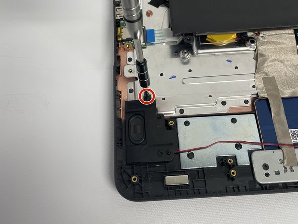

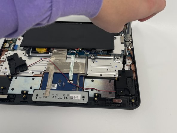

  5. Lenovo 300e Chromebook Speakers Replacement, Speakers: crwdns2935265:05crwdnd2935265:01crwdnd2935265:03crwdne2935265:0 Lenovo 300e Chromebook Speakers Replacement, Speakers: crwdns2935265:05crwdnd2935265:02crwdnd2935265:03crwdne2935265:0 Lenovo 300e Chromebook Speakers Replacement, Speakers: crwdns2935265:05crwdnd2935265:03crwdnd2935265:03crwdne2935265:0
    • Remove a single 5 mm screw from each speaker using a Phillips #2 screwdriver.
  6. Lenovo 300e Chromebook Speakers Replacement: crwdns2935265:06crwdnd2935265:01crwdnd2935265:03crwdne2935265:0 Lenovo 300e Chromebook Speakers Replacement: crwdns2935265:06crwdnd2935265:02crwdnd2935265:03crwdne2935265:0 Lenovo 300e Chromebook Speakers Replacement: crwdns2935265:06crwdnd2935265:03crwdnd2935265:03crwdne2935265:0
    • Disconnect the speaker cable from the motherboard.
    • Remove the speakers from the laptop.
