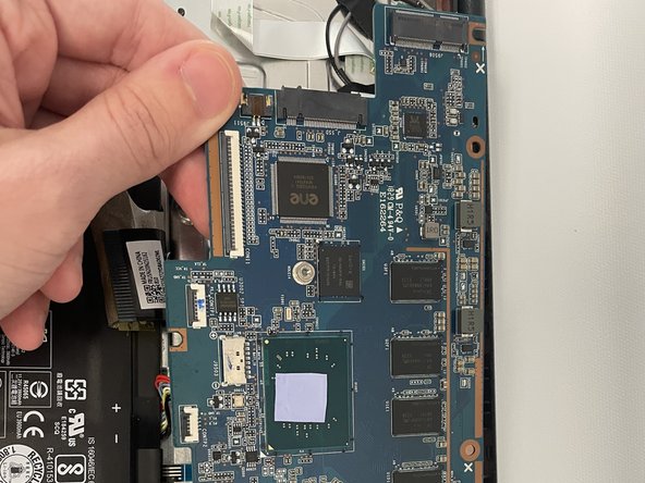

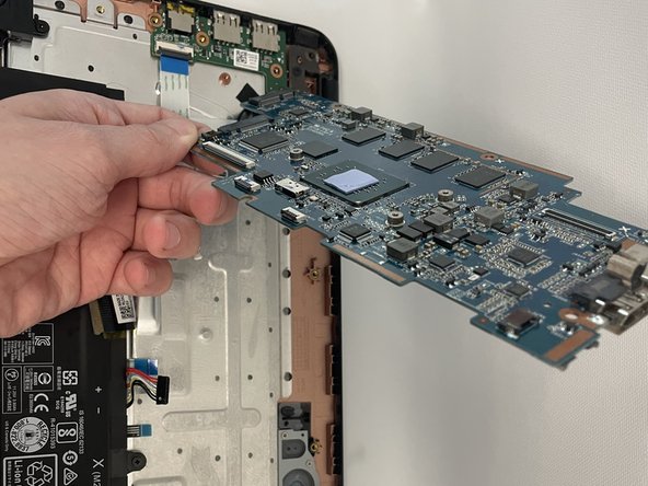

    • Remove the nine 3 mm screws from the motherboard using a Phillips #2 screwdriver.
    • Detach all the connectors from the motherboard.
  8. Lenovo 300e Chromebook Motherboard  Replacement: crwdns2935265:08crwdnd2935265:01crwdnd2935265:03crwdne2935265:0 Lenovo 300e Chromebook Motherboard  Replacement: crwdns2935265:08crwdnd2935265:02crwdnd2935265:03crwdne2935265:0 Lenovo 300e Chromebook Motherboard  Replacement: crwdns2935265:08crwdnd2935265:03crwdnd2935265:03crwdne2935265:0
    • Remove the tape using a spudger.
    • Disconnect the large cable connector.
    • Remove the motherboard from the laptop.
