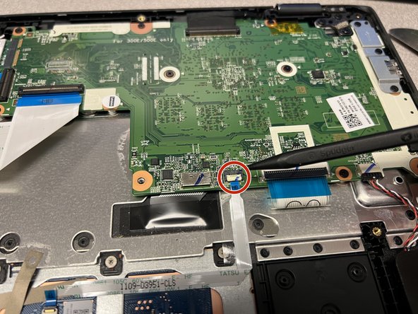

  2. Lenovo 300e Chromebook 2nd Gen Trackpad Replacement, Disconnect the Battery: crwdns2935265:02crwdnd2935265:01crwdnd2935265:02crwdne2935265:0 Lenovo 300e Chromebook 2nd Gen Trackpad Replacement, Disconnect the Battery: crwdns2935265:02crwdnd2935265:02crwdnd2935265:02crwdne2935265:0
    • Remove the black tape covering the connector, then using a spudge tool, carefully unplug the battery from the motherboard

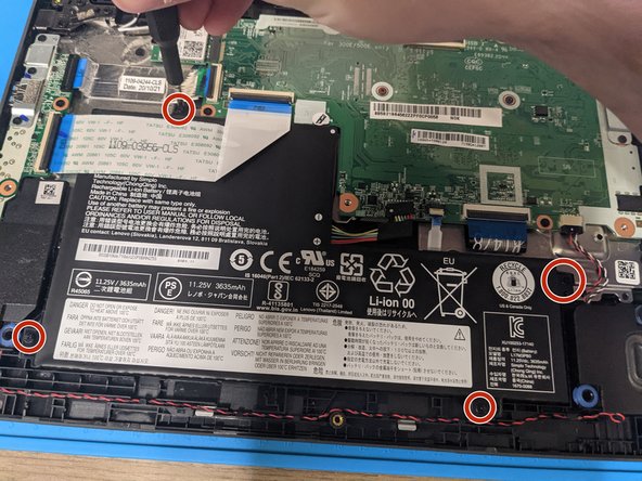

  3. Lenovo 300e Chromebook 2nd Gen Trackpad Replacement, Remove the battery: crwdns2935265:03crwdnd2935265:01crwdnd2935265:02crwdne2935265:0 Lenovo 300e Chromebook 2nd Gen Trackpad Replacement, Remove the battery: crwdns2935265:03crwdnd2935265:02crwdnd2935265:02crwdne2935265:0
    • Remove the 4 screws holding in the battery and set them aside
    • Make sure to separate the screws for the battery from the screws for the backing that were removed in the first step!

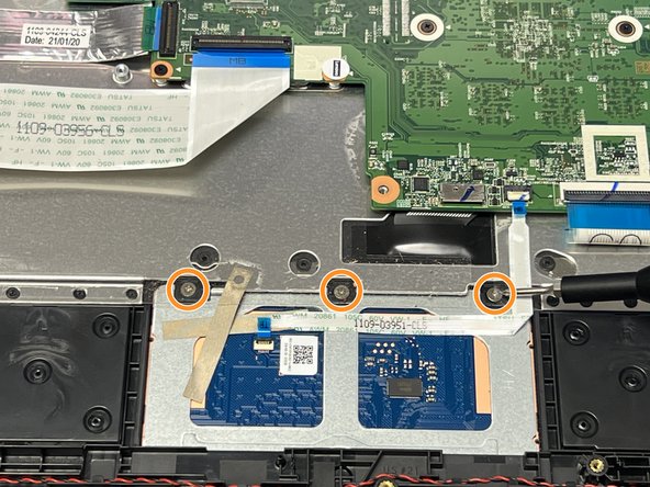

  4. Lenovo 300e Chromebook 2nd Gen Trackpad Replacement, Remove Trackpad Screws & Connector: crwdns2935265:04crwdnd2935265:01crwdnd2935265:03crwdne2935265:0 Lenovo 300e Chromebook 2nd Gen Trackpad Replacement, Remove Trackpad Screws & Connector: crwdns2935265:04crwdnd2935265:02crwdnd2935265:03crwdne2935265:0 Lenovo 300e Chromebook 2nd Gen Trackpad Replacement, Remove Trackpad Screws & Connector: crwdns2935265:04crwdnd2935265:03crwdnd2935265:03crwdne2935265:0
    Phillips #0 Screwdriver
    $5.49
    • Disconnect the Trackpad Cable by lifting the Connector.
    • Remove the 3 screws holding in the top of the trackpad with a Phillips #0 screwdriver
