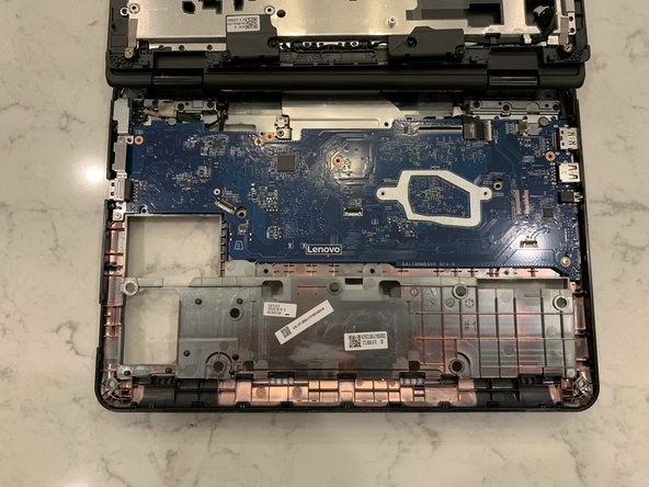

  2. Lenovo 11e ThinkPad Chromebook Write-Protect Screw Removal, Removing Screws from under laptop: crwdns2935265:02crwdnd2935265:01crwdnd2935265:03crwdne2935265:0 Lenovo 11e ThinkPad Chromebook Write-Protect Screw Removal, Removing Screws from under laptop: crwdns2935265:02crwdnd2935265:02crwdnd2935265:03crwdne2935265:0 Lenovo 11e ThinkPad Chromebook Write-Protect Screw Removal, Removing Screws from under laptop: crwdns2935265:02crwdnd2935265:03crwdnd2935265:03crwdne2935265:0
    • Unplug the Battery
    • Unscrew battery and remove
    • Remove all all circled screws
    • I removed the wireless card. I don't know if it's required.

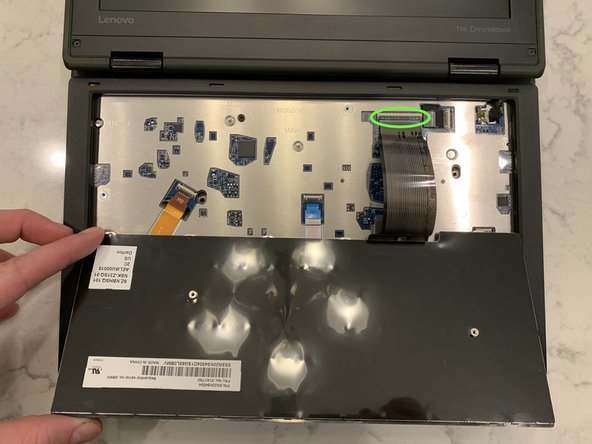

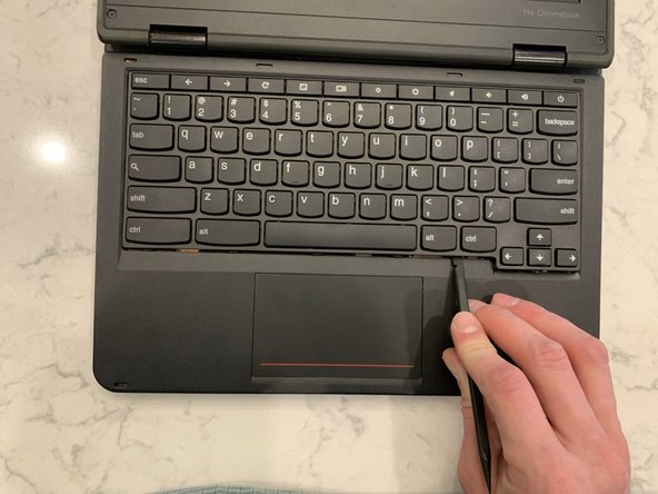

  3. Lenovo 11e ThinkPad Chromebook Write-Protect Screw Removal, Remove the Keyboard: crwdns2935265:03crwdnd2935265:01crwdnd2935265:03crwdne2935265:0 Lenovo 11e ThinkPad Chromebook Write-Protect Screw Removal, Remove the Keyboard: crwdns2935265:03crwdnd2935265:02crwdnd2935265:03crwdne2935265:0 Lenovo 11e ThinkPad Chromebook Write-Protect Screw Removal, Remove the Keyboard: crwdns2935265:03crwdnd2935265:03crwdnd2935265:03crwdne2935265:0
    • Slide Keyboard up
    • Wedge something under the keyboard
    • flip the keyboard over
    • carefully remove the keyboard ribbon cable

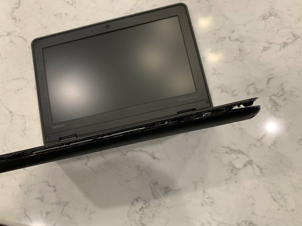

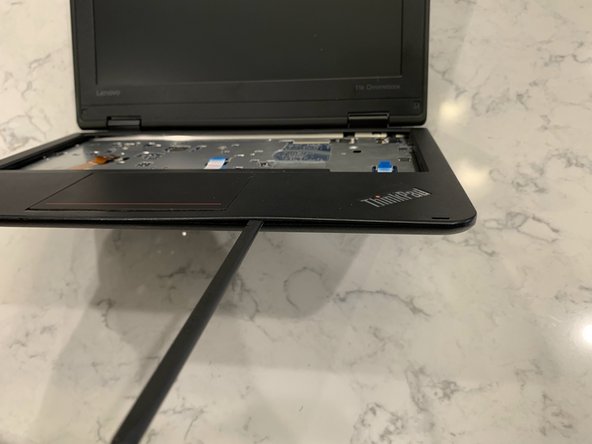

  4. Lenovo 11e ThinkPad Chromebook Write-Protect Screw Removal, Removing the Bezel: crwdns2935265:04crwdnd2935265:01crwdnd2935265:03crwdne2935265:0 Lenovo 11e ThinkPad Chromebook Write-Protect Screw Removal, Removing the Bezel: crwdns2935265:04crwdnd2935265:02crwdnd2935265:03crwdne2935265:0 Lenovo 11e ThinkPad Chromebook Write-Protect Screw Removal, Removing the Bezel: crwdns2935265:04crwdnd2935265:03crwdnd2935265:03crwdne2935265:0
    • Unscrew and disconnect ribbon cables
    • wedge something between the bezel and slide across the edge until the bezel is lifted (like taking off a bike tire)
  5. Lenovo 11e ThinkPad Chromebook Write-Protect Screw Removal, Remove the write-protect screw: crwdns2935265:05crwdnd2935265:01crwdnd2935265:02crwdne2935265:0 Lenovo 11e ThinkPad Chromebook Write-Protect Screw Removal, Remove the write-protect screw: crwdns2935265:05crwdnd2935265:02crwdnd2935265:02crwdne2935265:0
    • The write-protect screw is clearly conducting electricity (compare it to other screws on the board).
    • Leave the WP screw out of the laptop.
