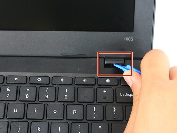

    • Carefully pry up and underneath both the (left & right) hinges of the screen cover.
