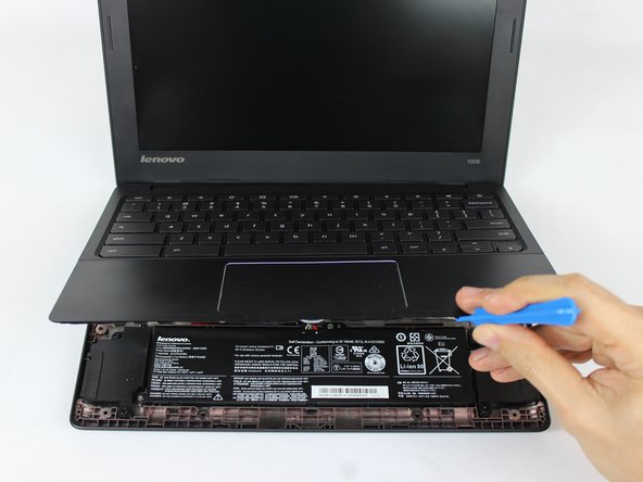

    • Turn your laptop back over, open it, and use the plastic opening tool on the recessed notch to gently pry each side and lift the keyboard plate up.
    • Be careful not to pull keyboard plate out immediately because cables are attached.

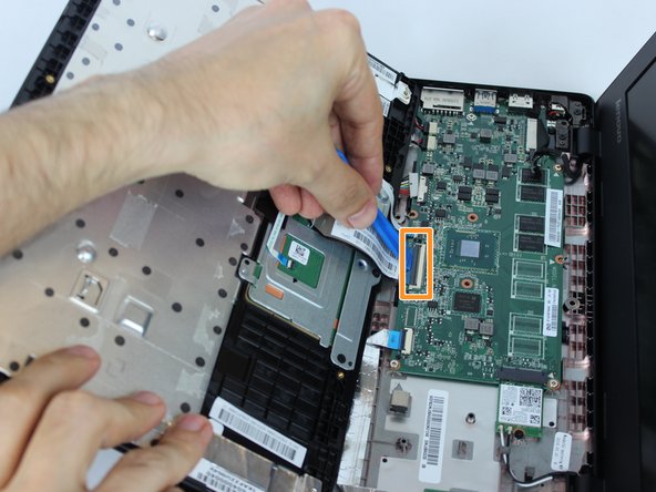

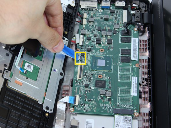

    • Locate the two sticker-like connecting wires (for the keyboard and touchpad).
    • Carefully unplug the orange circled (keyboard) wire from the keyboard plate.
    • Carefully unplug the yellow circled (touchpad) wire from the keyboard plate.
    • Then lift the keyboard plate up and place it to the side.
