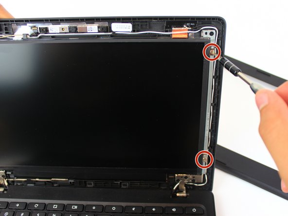

  5. Lenovo 100s Chromebook-11IBY Screen Replacement: crwdns2935265:05crwdnd2935265:01crwdnd2935265:02crwdne2935265:0 Lenovo 100s Chromebook-11IBY Screen Replacement: crwdns2935265:05crwdnd2935265:02crwdnd2935265:02crwdne2935265:0
    • Use the #0 Phillips screwdriver to remove the four 6mm screws from the screen.
