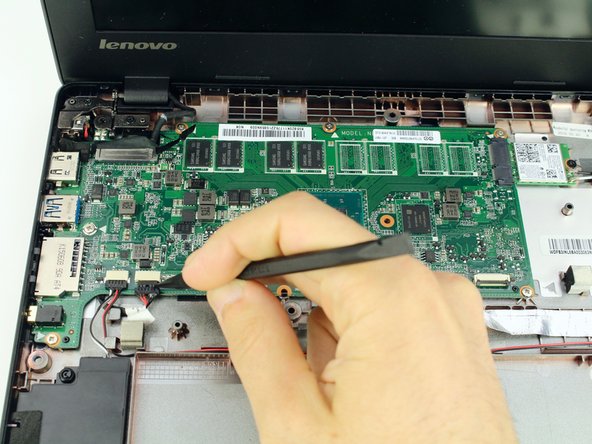

  8. Lenovo 100s Chromebook-11IBY Motherboard Replacement, Motherboard: crwdns2935265:08crwdnd2935265:01crwdnd2935265:03crwdne2935265:0 Lenovo 100s Chromebook-11IBY Motherboard Replacement, Motherboard: crwdns2935265:08crwdnd2935265:02crwdnd2935265:03crwdne2935265:0 Lenovo 100s Chromebook-11IBY Motherboard Replacement, Motherboard: crwdns2935265:08crwdnd2935265:03crwdnd2935265:03crwdne2935265:0
    • Using the black nylon spudger, lift up the grey bar of the ZIF connector attached to the motherboard located in the bottom right corner.
    • Pull out the ribbon cable connecting the motherboard to the daughterboard.

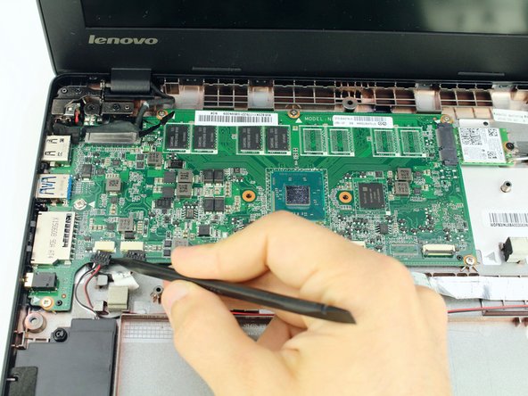

  9. Lenovo 100s Chromebook-11IBY Motherboard Replacement: crwdns2935265:09crwdnd2935265:01crwdnd2935265:03crwdne2935265:0 Lenovo 100s Chromebook-11IBY Motherboard Replacement: crwdns2935265:09crwdnd2935265:02crwdnd2935265:03crwdne2935265:0 Lenovo 100s Chromebook-11IBY Motherboard Replacement: crwdns2935265:09crwdnd2935265:03crwdnd2935265:03crwdne2935265:0
    • Use the spudger to coax the sliding speaker cables toward you, out of the motherboard attachments.

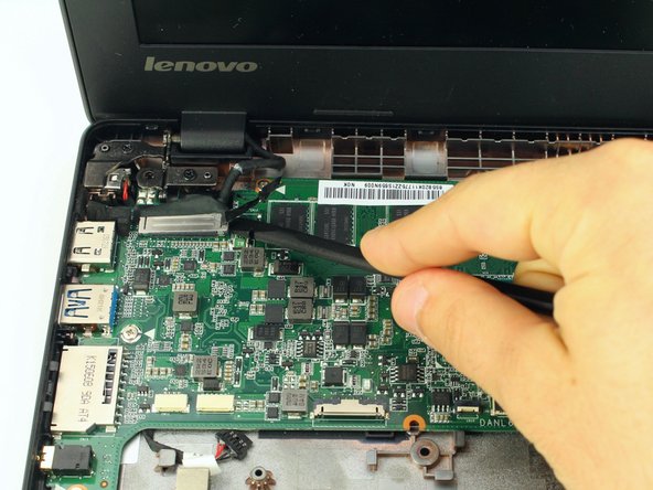

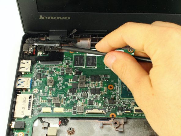

  10. Lenovo 100s Chromebook-11IBY Motherboard Replacement: crwdns2935265:010crwdnd2935265:01crwdnd2935265:03crwdne2935265:0 Lenovo 100s Chromebook-11IBY Motherboard Replacement: crwdns2935265:010crwdnd2935265:02crwdnd2935265:03crwdne2935265:0 Lenovo 100s Chromebook-11IBY Motherboard Replacement: crwdns2935265:010crwdnd2935265:03crwdnd2935265:03crwdne2935265:0
    • Use the flat end of the spudger to pop up the display cable connector from the motherboard.

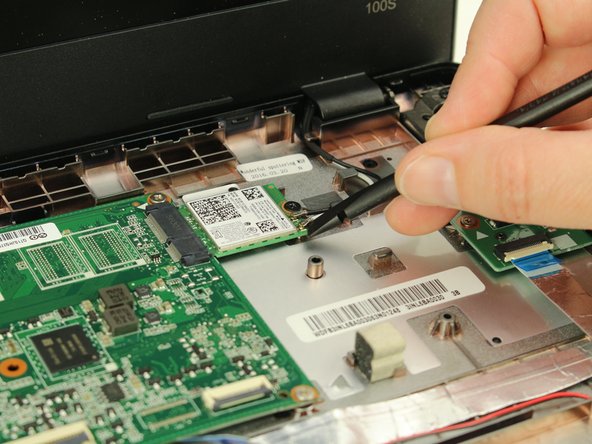

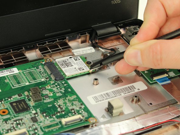

    • Pry up the coaxial antenna cables from the wifi card with the spudger.
