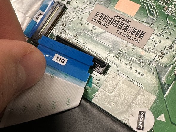

  4. Lenovo 100e Chromebook Display Removal, Disconnect Ribbon Cable: crwdns2935265:04crwdnd2935265:01crwdnd2935265:03crwdne2935265:0 Lenovo 100e Chromebook Display Removal, Disconnect Ribbon Cable: crwdns2935265:04crwdnd2935265:02crwdnd2935265:03crwdne2935265:0 Lenovo 100e Chromebook Display Removal, Disconnect Ribbon Cable: crwdns2935265:04crwdnd2935265:03crwdnd2935265:03crwdne2935265:0
    • For the ribbon cable, Carefully lift the locking flap on the connector, which secures the ribbon cable in place. These flaps are usually very delicate, so use a spudger or your fingernail to gently lift it up. It doesn’t come off entirely; just lifts up a little to release the tension on the cable.
    • Once the flap is lifted, gently pull the ribbon cable out of the connector. Pull straight out and avoid side-to-side motion to ensure the cable and its contacts aren’t damaged.

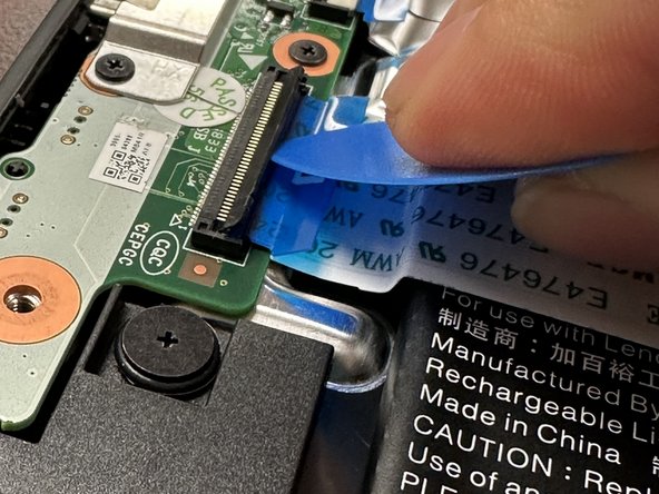

  5. Lenovo 100e Chromebook Display Removal, disconnect battery connection to motherboard: crwdns2935265:05crwdnd2935265:01crwdnd2935265:02crwdne2935265:0 Lenovo 100e Chromebook Display Removal, disconnect battery connection to motherboard: crwdns2935265:05crwdnd2935265:02crwdnd2935265:02crwdne2935265:0
    • Use a plastic tool such as the opening tool or opening pick to carefully disconnect the battery from the motherboard
    • This part is kind of difficult be careful not to break this cord pushing it out.

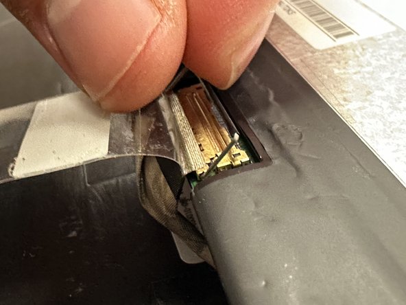

  8. Lenovo 100e Chromebook Display Removal, Disconnect Display cord: crwdns2935265:08crwdnd2935265:01crwdnd2935265:02crwdne2935265:0 Lenovo 100e Chromebook Display Removal, Disconnect Display cord: crwdns2935265:08crwdnd2935265:02crwdnd2935265:02crwdne2935265:0
    • Peel back the protective tape over the display cable using the spudger. Gently lift the black bar latch holding the cable in place, until the cable becomes loose. Pull the cable free and remove the display.
