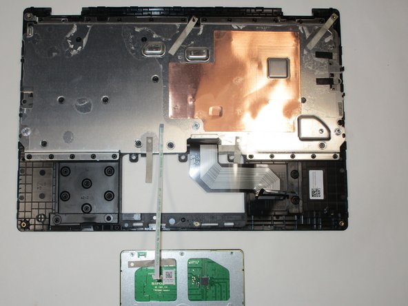

  4. Lenovo 100e Chromebook 2nd Gen Trackpad Replacement, Trackpad: crwdns2935265:04crwdnd2935265:01crwdnd2935265:01crwdne2935265:0
    • Remove the three 2 mm Phillips #00 screws holding the trackpad in.
  5. Lenovo 100e Chromebook 2nd Gen Trackpad Replacement: crwdns2935265:05crwdnd2935265:01crwdnd2935265:02crwdne2935265:0 Lenovo 100e Chromebook 2nd Gen Trackpad Replacement: crwdns2935265:05crwdnd2935265:02crwdnd2935265:02crwdne2935265:0
    • Push up on the side of the trackpad that faces the screen.
    • Pop the trackpad out and remove it from the laptop.
