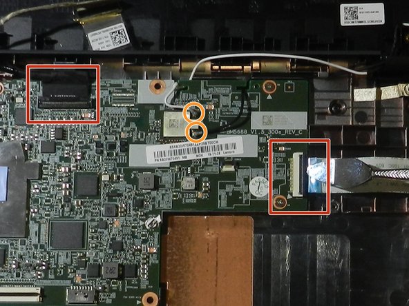

  15. Lenovo 100e Chromebook 2nd Gen Motherboard Replacement, Motherboard: crwdns2935265:015crwdnd2935265:01crwdnd2935265:02crwdne2935265:0 Lenovo 100e Chromebook 2nd Gen Motherboard Replacement, Motherboard: crwdns2935265:015crwdnd2935265:02crwdnd2935265:02crwdne2935265:0
    • Use the spudger to disconnect the two ribbon cables.
    • Disconnect the black and white coaxial cables.
  16. Lenovo 100e Chromebook 2nd Gen Motherboard Replacement: crwdns2935265:016crwdnd2935265:01crwdnd2935265:02crwdne2935265:0 Lenovo 100e Chromebook 2nd Gen Motherboard Replacement: crwdns2935265:016crwdnd2935265:02crwdnd2935265:02crwdne2935265:0
