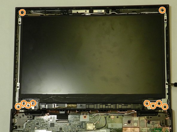

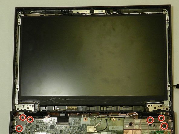

  13. Lenovo 100e Chromebook 2nd Gen Hinges Replacement, Hinges: crwdns2935265:013crwdnd2935265:01crwdnd2935265:03crwdne2935265:0 Lenovo 100e Chromebook 2nd Gen Hinges Replacement, Hinges: crwdns2935265:013crwdnd2935265:02crwdnd2935265:03crwdne2935265:0 Lenovo 100e Chromebook 2nd Gen Hinges Replacement, Hinges: crwdns2935265:013crwdnd2935265:03crwdnd2935265:03crwdne2935265:0
    • Use the Phillips #0 screwdriver to remove the six 4.7 mm screws located on the bottom half of each hinge.
    • Use the Phillips #00 screwdriver to remove the ten 3.4 mm screws located on the upper hinge assembly.
  14. Lenovo 100e Chromebook 2nd Gen Hinges Replacement: crwdns2935265:014crwdnd2935265:01crwdnd2935265:01crwdne2935265:0
    • Move the screen assembly perpendicular to the keyboard assembly.
    • Remove the hinges by pulling straight up.
