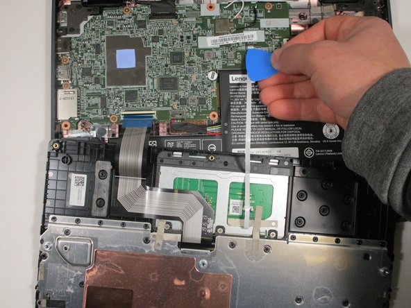

    • Lift the keyboard connectors up using an opening pick.
    • Remove the connectors from their sockets.

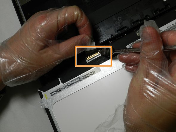

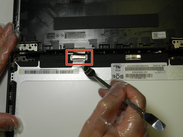

    • Peel back the protective tape over the display cable using the spudger.
    • Gently lift the black bar latch holding the cable in place, until the cable becomes loose.
    • Pull the cable free and remove the display.
    • DO NOT pull on the cable before lifting the bar latch or the cable will break.
