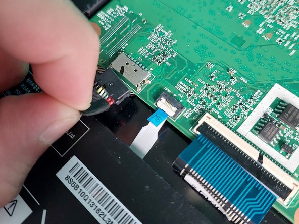

  3. Lenovo 100e Chromebook (1st Gen) Wi-Fi/Bluetooth Card Replacement, Disconnect the battery: crwdns2935265:03crwdnd2935265:01crwdnd2935265:02crwdne2935265:0 Lenovo 100e Chromebook (1st Gen) Wi-Fi/Bluetooth Card Replacement, Disconnect the battery: crwdns2935265:03crwdnd2935265:02crwdnd2935265:02crwdne2935265:0
    • In the lower side of the motherboard you will find the battery connector.
    • To disconnect the battery, carefully pull the black connector in a parallel direction to the laptop.
    • Remember to take the conector out fully to avoid any shortcircuits.

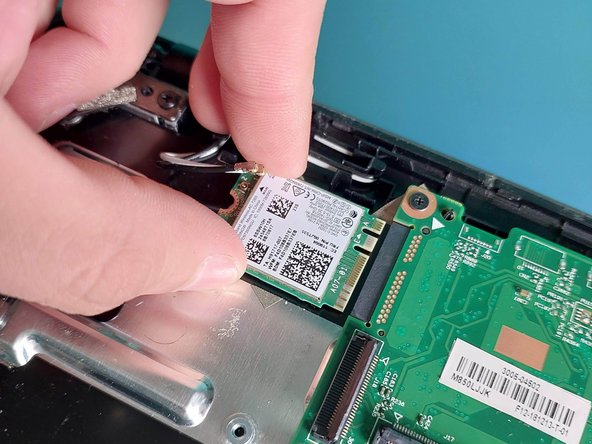

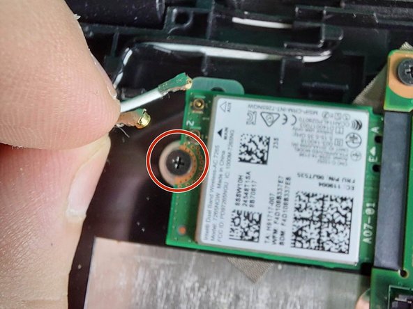

  4. Lenovo 100e Chromebook (1st Gen) Wi-Fi/Bluetooth Card Replacement, Remove Wi-Fi Card: crwdns2935265:04crwdnd2935265:01crwdnd2935265:03crwdne2935265:0 Lenovo 100e Chromebook (1st Gen) Wi-Fi/Bluetooth Card Replacement, Remove Wi-Fi Card: crwdns2935265:04crwdnd2935265:02crwdnd2935265:03crwdne2935265:0 Lenovo 100e Chromebook (1st Gen) Wi-Fi/Bluetooth Card Replacement, Remove Wi-Fi Card: crwdns2935265:04crwdnd2935265:03crwdnd2935265:03crwdne2935265:0
    • You will find the Card on the top left corner of the chassis.
    • Carefully disconnect the antenna cables from the card with an upward movement.
    • Notice these cables have colors that match the ones printed on the sticker of the Card.
    • Remove the Phillips head screw.
    • Pull from the motherboard in a parallel direction.

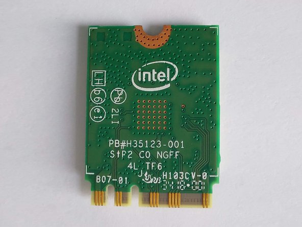

  5. Lenovo 100e Chromebook (1st Gen) Wi-Fi/Bluetooth Card Replacement, Wi-Fi Card Overview: crwdns2935265:05crwdnd2935265:01crwdnd2935265:02crwdne2935265:0 Lenovo 100e Chromebook (1st Gen) Wi-Fi/Bluetooth Card Replacement, Wi-Fi Card Overview: crwdns2935265:05crwdnd2935265:02crwdnd2935265:02crwdne2935265:0
    • This is an Intel WiFi + Bluetooth Combo card. The model on this card is "7265NGW".
    • It has a M.2 1216 size format.
    • Wi-Fi 5 (802.11ac) and Dual Band (2.4 GHz and 5.0 GHz) compatible.
    • Bluetooth 4.2 compliant.
