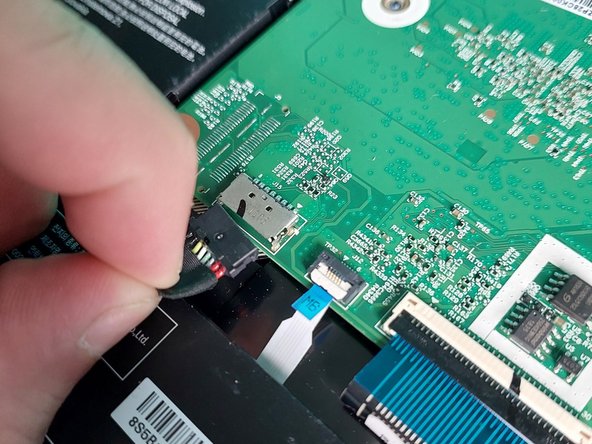

  3. Lenovo 100e Chromebook (1st Gen) Battery Replacement, Disconnect the battery: crwdns2935265:03crwdnd2935265:01crwdnd2935265:02crwdne2935265:0 Lenovo 100e Chromebook (1st Gen) Battery Replacement, Disconnect the battery: crwdns2935265:03crwdnd2935265:02crwdnd2935265:02crwdne2935265:0
    • In the lower side of the motherboard you will find the battery connector.
    • To disconnect the battery, carefully pull the black connector in a parallel direction to the laptop.
    • Remember to take the conector out fully to avoid any shortcircuits.

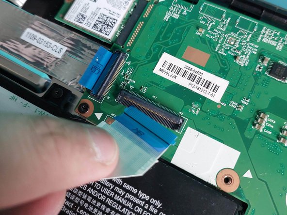

  4. Lenovo 100e Chromebook (1st Gen) Battery Replacement, Disconnnect Daughterboard: crwdns2935265:04crwdnd2935265:01crwdnd2935265:03crwdne2935265:0 Lenovo 100e Chromebook (1st Gen) Battery Replacement, Disconnnect Daughterboard: crwdns2935265:04crwdnd2935265:02crwdnd2935265:03crwdne2935265:0 Lenovo 100e Chromebook (1st Gen) Battery Replacement, Disconnnect Daughterboard: crwdns2935265:04crwdnd2935265:03crwdnd2935265:03crwdne2935265:0
    • The daugtherboard ribbon it's over the battery.
    • Lift the clip on the motherboard connector.
    • Take out the ribbon cable in an up and out direction from the motherboard connector.
    • Gently peel it off, it has some mild glue to attach it to the battery.
    • YOU MUST NEVER BEND THIS RIBBON IN A HARD WAY!

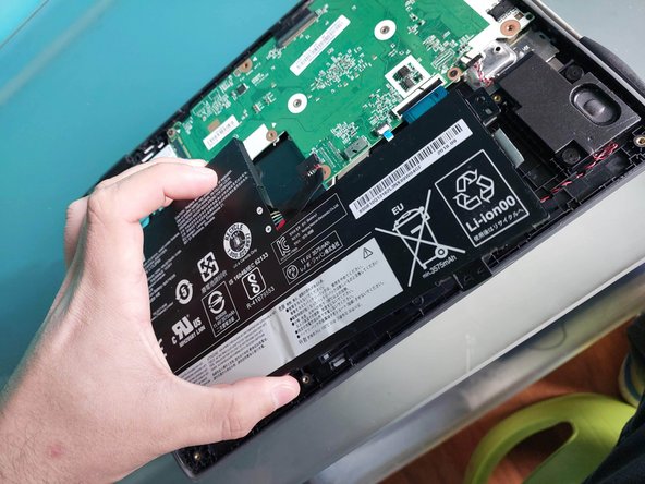

  5. Lenovo 100e Chromebook (1st Gen) Battery Replacement, Remove the battery: crwdns2935265:05crwdnd2935265:01crwdnd2935265:02crwdne2935265:0 Lenovo 100e Chromebook (1st Gen) Battery Replacement, Remove the battery: crwdns2935265:05crwdnd2935265:02crwdnd2935265:02crwdne2935265:0
    • Remove the four Phillips head screws attaching the Battery.
    • Lift the battery from the casing.
    • If you are changing it for a new one, make sure you are disposing the old one in a safe way.
  6. Lenovo 100e Chromebook (1st Gen) Battery Replacement, Battery overview: crwdns2935265:06crwdnd2935265:01crwdnd2935265:01crwdne2935265:0
    • This is a Li-ion Battery.
    • It runs at 11.4V and it has a 3685 mAh capacity.
    • For this model it reads battery model as "L17L3PB0". The main difference with another similar batteries is the location of its anchor points. Make sure they're the same when ordering.
