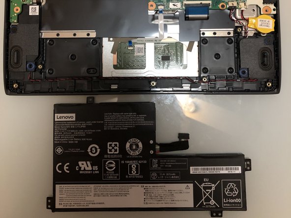

    • Before you begin, make sure the laptop is powered off and unplug all cables from the device.
    • Use the Phillips #0 screwdriver to remove the nine 1.2 mm screws on the bottom side of the laptop.
  2. Lenovo 100e 2nd gen Battery Replacement: crwdns2935265:02crwdnd2935265:01crwdnd2935265:03crwdne2935265:0 Lenovo 100e 2nd gen Battery Replacement: crwdns2935265:02crwdnd2935265:02crwdnd2935265:03crwdne2935265:0 Lenovo 100e 2nd gen Battery Replacement: crwdns2935265:02crwdnd2935265:03crwdnd2935265:03crwdne2935265:0
    • Use a plastic opening tool to pry the bottom cover from the laptop.
    • Pry all four sides of the bottom panel to safely remove the bottom panel from the device.
    • Carefully remove the bottom panel and place it to the side.

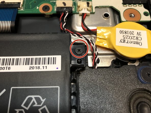

  3. Lenovo 100e 2nd gen Battery Replacement: crwdns2935265:03crwdnd2935265:01crwdnd2935265:03crwdne2935265:0 Lenovo 100e 2nd gen Battery Replacement: crwdns2935265:03crwdnd2935265:02crwdnd2935265:03crwdne2935265:0 Lenovo 100e 2nd gen Battery Replacement: crwdns2935265:03crwdnd2935265:03crwdnd2935265:03crwdne2935265:0
    • Use a Phillips #0 screwdriver to remove the four 1 mm screws that are holding the battery in place.

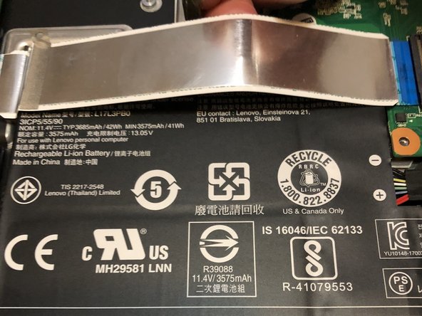

  4. Lenovo 100e 2nd gen Battery Replacement: crwdns2935265:04crwdnd2935265:01crwdnd2935265:03crwdne2935265:0 Lenovo 100e 2nd gen Battery Replacement: crwdns2935265:04crwdnd2935265:02crwdnd2935265:03crwdne2935265:0 Lenovo 100e 2nd gen Battery Replacement: crwdns2935265:04crwdnd2935265:03crwdnd2935265:03crwdne2935265:0
    • Unplug the battery from the motherboard.
    • Lift the daughterboard ribbon to make it easier to remove the battery safely.
    • Completely remove the old battery and place it to the side.

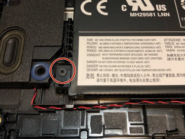

  5. Lenovo 100e 2nd gen Battery Replacement: crwdns2935265:05crwdnd2935265:01crwdnd2935265:02crwdne2935265:0 Lenovo 100e 2nd gen Battery Replacement: crwdns2935265:05crwdnd2935265:02crwdnd2935265:02crwdne2935265:0
    • Insert the new battery by connecting the battery to the motherboard.
    • Lift the daughterboard ribbon and place the new battery under the ribbon.
