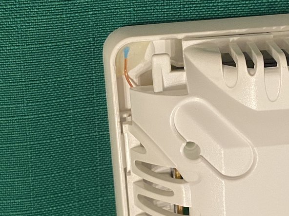

    • Using the guitar pick or small flat screwdriver, gently pry the bezel rim away from the back plate to free the locking tabs. Take note of the small sensor glued into one corner and start your prying opposite to it. There are 10 tabs, but after you get the first 3 or 4 free the rest are easier. Just don't pry beyond what is needed to clear the tabs!

    • There is nothing attached to the back plate so just set it aside. The capacitors may have some glue stuck to their bases. Just pick this off; it was used to hold them in place during assembly and need not be replaced.
