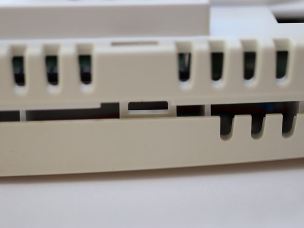

    • Locate the plastic tabs, and using a flat headed screwdriver, push them inward. This may take some force, but the plastic should give fairly easily.

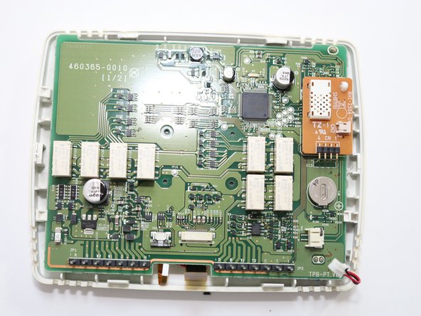

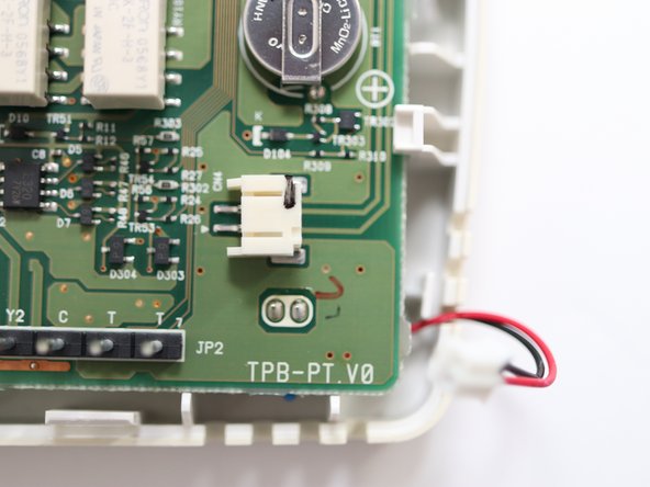

    • The board is exposed! Now simply push back the plastic tabs connecting the board and disconnect the cables
  5. Lennox Y0349 Thermostat Teardown, Board and LCD - Closer Look: crwdns2935265:05crwdnd2935265:01crwdnd2935265:03crwdne2935265:0 Lennox Y0349 Thermostat Teardown, Board and LCD - Closer Look: crwdns2935265:05crwdnd2935265:02crwdnd2935265:03crwdne2935265:0 Lennox Y0349 Thermostat Teardown, Board and LCD - Closer Look: crwdns2935265:05crwdnd2935265:03crwdnd2935265:03crwdne2935265:0

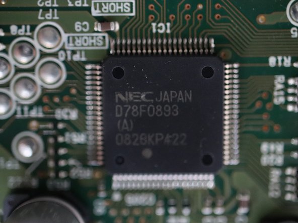

    • Now that the board is removed, we see 8 3 volt relays, the temperature and humidity sensor (on it's own board) a small battery, and the microprocessor.

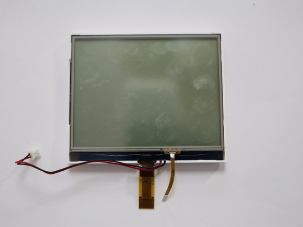

    • The screen has 3 cables (the wide one is for the LCD, the skinny one if for the digitizer, and the simple, red and black one is for the backlighting.
  6. Lennox Y0349 Thermostat Teardown, Open the Display: crwdns2935265:06crwdnd2935265:01crwdnd2935265:01crwdne2935265:0
    • The screen and be opened to expose the LCD and the backlighting
