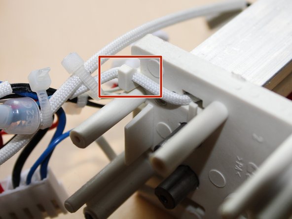

  3. Leitz iLam Home Office A4 Disassembly, Remove the cylinder motor: crwdns2935265:03crwdnd2935265:01crwdnd2935265:03crwdne2935265:0 Leitz iLam Home Office A4 Disassembly, Remove the cylinder motor: crwdns2935265:03crwdnd2935265:02crwdnd2935265:03crwdne2935265:0 Leitz iLam Home Office A4 Disassembly, Remove the cylinder motor: crwdns2935265:03crwdnd2935265:03crwdnd2935265:03crwdne2935265:0
    • Remove two screws.
    • Be careful on small parts that fall down one's you unscrew the screws.
    • Carefully release cable from tiny holder.
