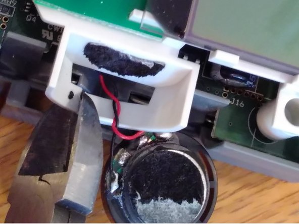

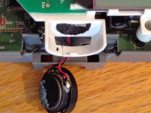

  3. Lego Mindstorms NXT brick with blank LCD screen, Free the speaker and its cable.: crwdns2935265:03crwdnd2935265:01crwdnd2935265:03crwdne2935265:0 Lego Mindstorms NXT brick with blank LCD screen, Free the speaker and its cable.: crwdns2935265:03crwdnd2935265:02crwdnd2935265:03crwdne2935265:0 Lego Mindstorms NXT brick with blank LCD screen, Free the speaker and its cable.: crwdns2935265:03crwdnd2935265:03crwdnd2935265:03crwdne2935265:0
    • Very gently pry the speaker away from the white plastic case. It is held with a sticky foam pad.
    • Move the speaker and its wires aside and cut a small channel in the plastic to allow the cables to pass through. TAKE CARE NOT TO CUT THE CABLES.

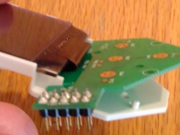

  5. Lego Mindstorms NXT brick with blank LCD screen, Heat and then apply pressure to ribbon cable connection.: crwdns2935265:05crwdnd2935265:01crwdnd2935265:02crwdne2935265:0 Lego Mindstorms NXT brick with blank LCD screen, Heat and then apply pressure to ribbon cable connection.: crwdns2935265:05crwdnd2935265:02crwdnd2935265:02crwdne2935265:0
    • I protected the LCD screen itself with a silicon baking mould (not sure if that was necessary!) Heat the part of the ribbon cable that attaches to the pcb. I gave it 10 secs with a small heat gun.
    • Apply pressure to the area - You want to avoid puncturing the shiny protective cover-tape but to compress and hopefully re-connect the tiny terminals underneath. There are about ten of them, so i used the sharp end of a spudger and rubbed back and forth parallel to the ribbon
