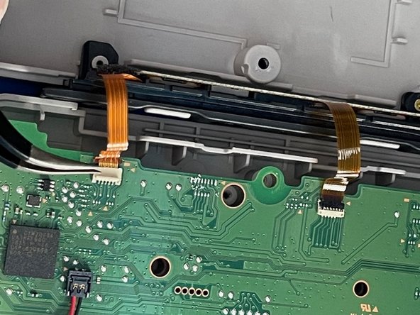

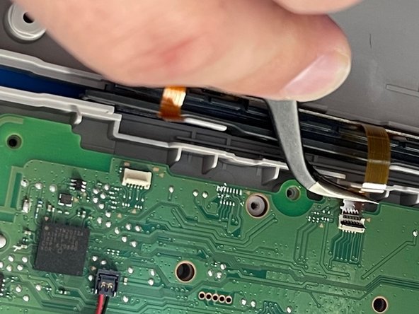

  3. Left Nintendo Switch NES Controller Charging Rail Replacement, Pry the ZIF connectors up: crwdns2935265:03crwdnd2935265:01crwdnd2935265:03crwdne2935265:0 Left Nintendo Switch NES Controller Charging Rail Replacement, Pry the ZIF connectors up: crwdns2935265:03crwdnd2935265:02crwdnd2935265:03crwdne2935265:0 Left Nintendo Switch NES Controller Charging Rail Replacement, Pry the ZIF connectors up: crwdns2935265:03crwdnd2935265:03crwdnd2935265:03crwdne2935265:0
    • Use the tip of a spudger or your fingernail to flip up the small locking flaps on the two ZIF Connectors. Then, you can safely pull the cable out.
    • Be sure to pry up on the hinged flap, not the connector socket.

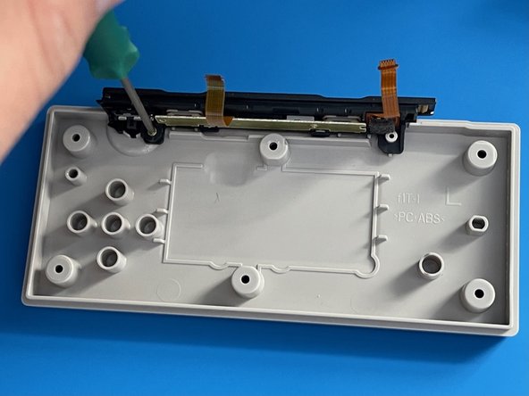

  4. Left Nintendo Switch NES Controller Charging Rail Replacement, Remove the charging rail: crwdns2935265:04crwdnd2935265:01crwdnd2935265:03crwdne2935265:0 Left Nintendo Switch NES Controller Charging Rail Replacement, Remove the charging rail: crwdns2935265:04crwdnd2935265:02crwdnd2935265:03crwdne2935265:0 Left Nintendo Switch NES Controller Charging Rail Replacement, Remove the charging rail: crwdns2935265:04crwdnd2935265:03crwdnd2935265:03crwdne2935265:0
    • Use a Phillips #000 to remove the single 3.0 mm screw holding the charging rail to the back plate.
    • Remove the charging rail.

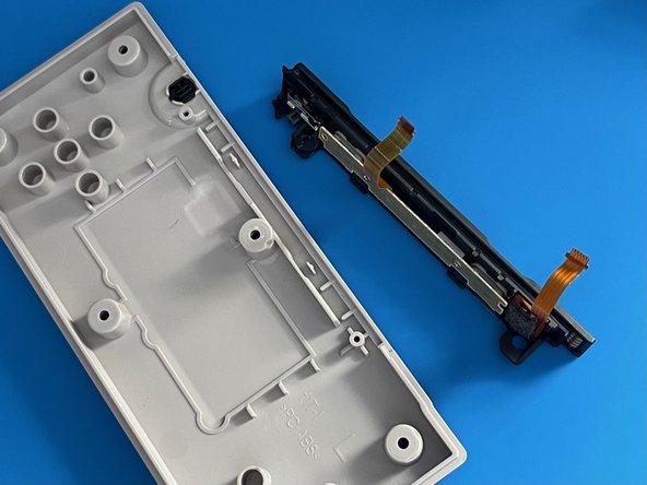

  5. Left Nintendo Switch NES Controller Charging Rail Replacement, Remove the rail PCB: crwdns2935265:05crwdnd2935265:01crwdnd2935265:03crwdne2935265:0 Left Nintendo Switch NES Controller Charging Rail Replacement, Remove the rail PCB: crwdns2935265:05crwdnd2935265:02crwdnd2935265:03crwdne2935265:0 Left Nintendo Switch NES Controller Charging Rail Replacement, Remove the rail PCB: crwdns2935265:05crwdnd2935265:03crwdnd2935265:03crwdne2935265:0
    • Use a Phillips #000 screwdriver to remove two 3.0mm screws from the rail PCB.
    • Remove the charging rail PCB.

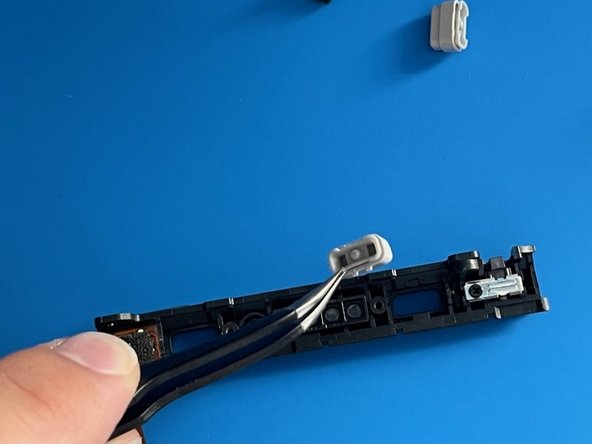

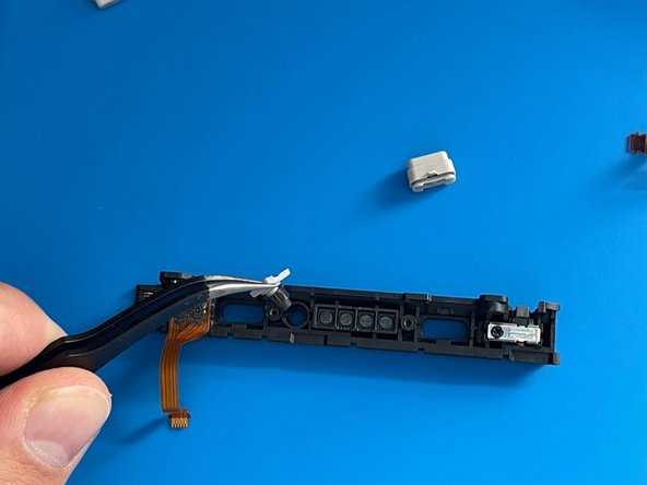

  6. Left Nintendo Switch NES Controller Charging Rail Replacement, Take the SL, SR and Sync buttons out: crwdns2935265:06crwdnd2935265:01crwdnd2935265:03crwdne2935265:0 Left Nintendo Switch NES Controller Charging Rail Replacement, Take the SL, SR and Sync buttons out: crwdns2935265:06crwdnd2935265:02crwdnd2935265:03crwdne2935265:0 Left Nintendo Switch NES Controller Charging Rail Replacement, Take the SL, SR and Sync buttons out: crwdns2935265:06crwdnd2935265:03crwdnd2935265:03crwdne2935265:0
    • Using tweezers, remove the SL and SR buttons.
    • Do the same for the Sync button between them.
