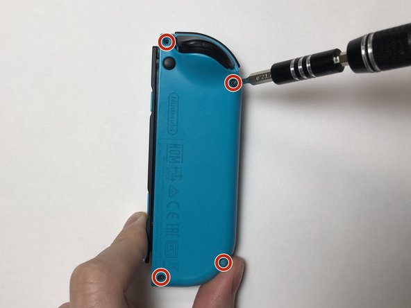

  1. Left Joy-Con Charging Rail Replacement, Charging Rail: crwdns2935265:01crwdnd2935265:01crwdnd2935265:02crwdne2935265:0 Left Joy-Con Charging Rail Replacement, Charging Rail: crwdns2935265:01crwdnd2935265:02crwdnd2935265:02crwdne2935265:0
    • Use the Tri-point Y00 screwdriver to remove the four 6 mm screws from the back of the Joy-Con.

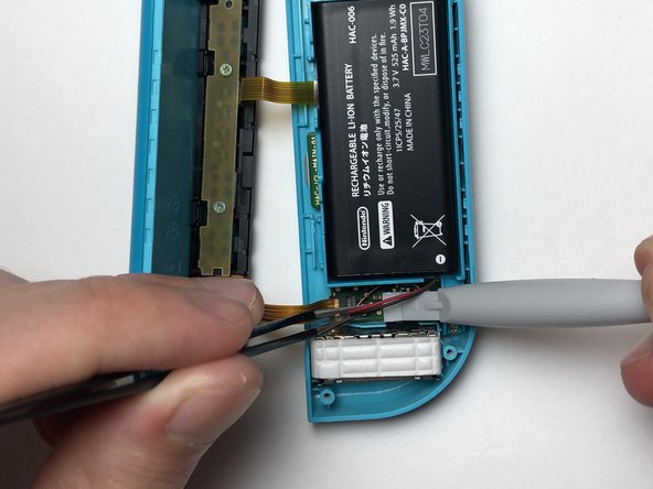

  3. Left Joy-Con Charging Rail Replacement: crwdns2935265:03crwdnd2935265:01crwdnd2935265:03crwdne2935265:0 Left Joy-Con Charging Rail Replacement: crwdns2935265:03crwdnd2935265:02crwdnd2935265:03crwdne2935265:0 Left Joy-Con Charging Rail Replacement: crwdns2935265:03crwdnd2935265:03crwdnd2935265:03crwdne2935265:0
    • Insert a spudger or prying tool beneath the battery wires and gently pry the battery plug out of the socket on the motherboard.
    • Once the battery plug is removed from the socket, lift the battery off the mid-frame.
    • A spudger is recommended for this step if one is available. If not, use an ESD safe tool.

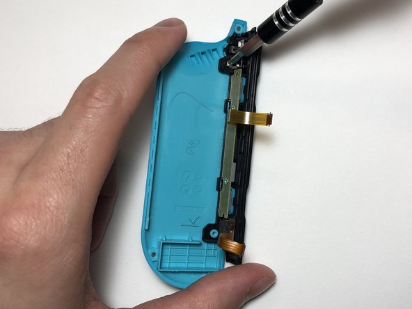

    • Unlatch the two ZIF connectors that are locking the ribbon cables on the charging rail to the motherboard.
    • Use tweezers to gently pull the ribbon cables out of the ZIF connectors.

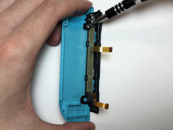

    • Remove the 2 mm Philips #000 screw holding the charging rail onto the back shell.
    • Remove the charging rail from the back shell.
    • There is an adhesive tape that helps keep the charging rail in place on the back shell. When placing the new charging rail onto the back shell, it is advised to also replace the adhesive to add extra support, but it is not essential.

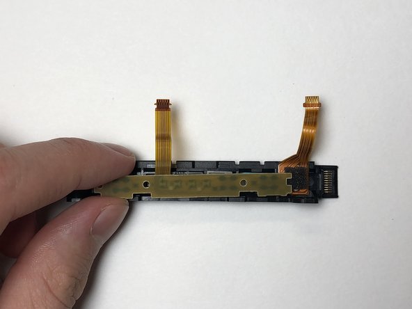

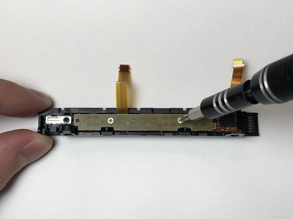

  8. Left Joy-Con Charging Rail Replacement: crwdns2935265:08crwdnd2935265:01crwdnd2935265:02crwdne2935265:0 Left Joy-Con Charging Rail Replacement: crwdns2935265:08crwdnd2935265:02crwdnd2935265:02crwdne2935265:0
    • Use the Phillips #000 screwdriver to remove the two 3 mm screws at the center of the PCB.
    • Remove the PCB from the charging rail.
  9. Left Joy-Con Charging Rail Replacement: crwdns2935265:09crwdnd2935265:01crwdnd2935265:03crwdne2935265:0 Left Joy-Con Charging Rail Replacement: crwdns2935265:09crwdnd2935265:02crwdnd2935265:03crwdne2935265:0 Left Joy-Con Charging Rail Replacement: crwdns2935265:09crwdnd2935265:03crwdnd2935265:03crwdne2935265:0
    • Remove the SL, SR and sync buttons from the charging rail.
  10. Left Joy-Con Charging Rail Replacement: crwdns2935265:010crwdnd2935265:01crwdnd2935265:03crwdne2935265:0 Left Joy-Con Charging Rail Replacement: crwdns2935265:010crwdnd2935265:02crwdnd2935265:03crwdne2935265:0 Left Joy-Con Charging Rail Replacement: crwdns2935265:010crwdnd2935265:03crwdnd2935265:03crwdne2935265:0
    • Place the SL, SR and sync buttons into the new charging rail and make sure the tabs on the SL and SR buttons fit into their respective socket grooves.
    • Place the PCB over the buttons and secure it in place using the two golden 3 mm Phillips #000 screws.
    • Potential for device damage. If the buttons are not properly placed into the charging rail, proceeding to screw in the PCB will cause it to warp.
  11. Left Joy-Con Charging Rail Replacement: crwdns2935265:011crwdnd2935265:01crwdnd2935265:02crwdne2935265:0 Left Joy-Con Charging Rail Replacement: crwdns2935265:011crwdnd2935265:02crwdnd2935265:02crwdne2935265:0
    • Align the charging rail with the two standoffs on the back shell.
    • Secure the rail onto the back shell using the 2 mm Phillips #000 screws.
  12. Left Joy-Con Charging Rail Replacement: crwdns2935265:012crwdnd2935265:01crwdnd2935265:03crwdne2935265:0 Left Joy-Con Charging Rail Replacement: crwdns2935265:012crwdnd2935265:02crwdnd2935265:03crwdne2935265:0 Left Joy-Con Charging Rail Replacement: crwdns2935265:012crwdnd2935265:03crwdnd2935265:03crwdne2935265:0
    • Use tweezers to insert the ribbon cables for the charging rail into the ZIF connectors on the motherboard.
    • Press down on the latch for each ZIF connector to secure the ribbon cables in place.

  15. Left Joy-Con Charging Rail Replacement: crwdns2935265:015crwdnd2935265:01crwdnd2935265:02crwdne2935265:0 Left Joy-Con Charging Rail Replacement: crwdns2935265:015crwdnd2935265:02crwdnd2935265:02crwdne2935265:0
    • Place the battery into the mid-frame.
    • Use tweezers to align the battery plug over the socket and with a pry tool or an object with a flat edge, press the plug into the socket.

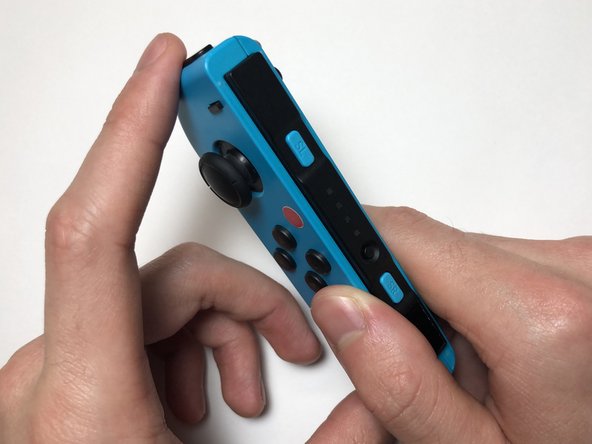

    • Align the charging rail into the notch on the left side of the Joy-Con.
    • Apply even pressure on both sides of the Joy-Con until the two shells click together.
    • Screw in the four 6 mm Tri-point Y00 screws into the back of the Joy-Con.
