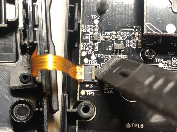

    3. Left Controller, Disconnect ribbon cable: crwdns2935265:03crwdnd2935265:01crwdnd2935265:03crwdne2935265:0 Left Controller, Disconnect ribbon cable: crwdns2935265:03crwdnd2935265:02crwdnd2935265:03crwdne2935265:0 Left Controller, Disconnect ribbon cable: crwdns2935265:03crwdnd2935265:03crwdnd2935265:03crwdne2935265:0
      • Use a plastic spudger to flip the ribbon cable latch up as shown in the first two images.
      • Remove the ribbon cable from the slot by pulling gently to the left with tweezers or fingers.

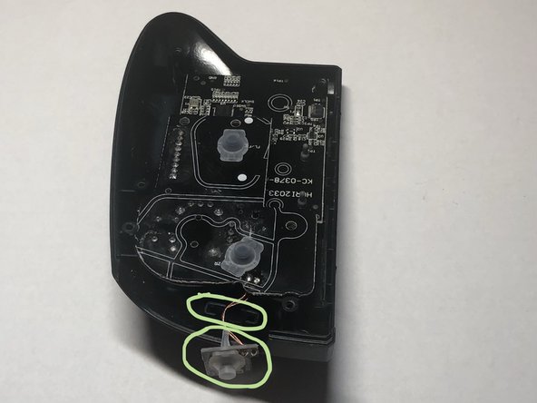

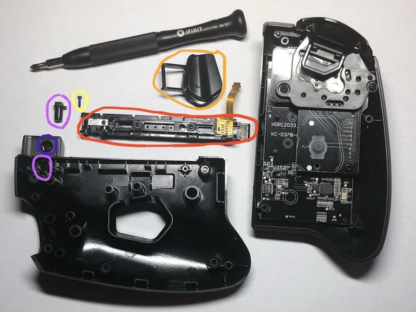

    4. Left Controller, Disassemble back half: crwdns2935265:04crwdnd2935265:01crwdnd2935265:02crwdne2935265:0 Left Controller, Disassemble back half: crwdns2935265:04crwdnd2935265:02crwdnd2935265:02crwdne2935265:0
      • Remove one PH00 screw that is securing the rail to the back half.
      • The FL button can be removed by placing a lever/spudger under the circled area.
      • The rail connector can be removed once the yellow circled screw is removed.
      • The button that releases the buckle lock can be removed after the rail and goes in the hole circled on the back half of the controller.
      • The one remaining screw does not need to be removed as it only secures a bit of plastic.

Thank you for the writing this guide. It is very helpful. Is there anywhere you know of that sells replacement ribbon cables? It has detached from the latch and I am not sure if it is salvageable.
Thanks a lot.
keen2fixstuff - crwdns2934203:0crwdne2934203:0 crwdns2950251:0crwdne2950251:0
Doubtful that you'd be able to find a replacement unless you have another set of the same controllers. The ribbon cable is supposed to come out of the latched cable connector like shown in Step 3. You should be able to put it back into the cable connector and flip the latch back down to hold it in. The cable connector is very flat and the ribbon cable only fits in from the one direction. Hope that helps.
