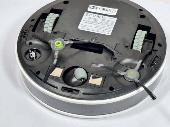

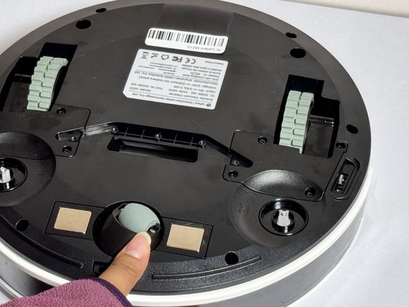

    • Flip the Lefant M210 over to have a clear view of the brushes.

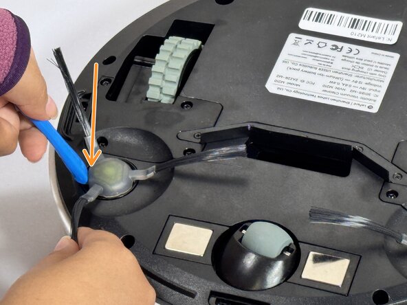

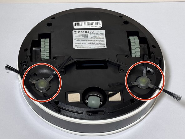

    • Place the blue tool under the circular part of the brush in the center
    • Push down the other end of the tool to pop out the brush component
    • When replacing, align the bottom of the brush with the connector on the vacuum and push down to set it in place.
