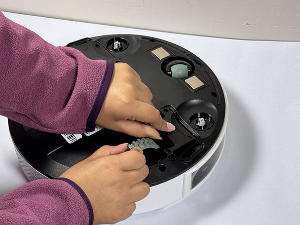

    • Turn off the Lefant M210 and disconnect it from the charging dock.
    • Flip the unit over so the bottom faces upward.
    • Locate the circular brush assemblies on the left and right sides of the underside.
    • Place the unit on a clean, flat surface to prevent scratching.
  2. Lefant M210 Battery Replacement: crwdns2935265:02crwdnd2935265:01crwdnd2935265:03crwdne2935265:0 Lefant M210 Battery Replacement: crwdns2935265:02crwdnd2935265:02crwdnd2935265:03crwdne2935265:0 Lefant M210 Battery Replacement: crwdns2935265:02crwdnd2935265:03crwdnd2935265:03crwdne2935265:0
    • Insert the iFixit Opening Tool (or similar pry tool) under the circular edge of the brush assembly.
    • Apply gentle downward pressure on the opposite end of the tool to lever the brush component out of its housing.
    • Remove the brush assembly completely and set it aside.
    • If replacing both brush assemblies, repeat this process on the other side.
    • Avoid using excessive force, which may damage the mounting clips.
    • Position the new brush assembly above the square mounting peg.
    • Align the square cavity on the bottom of the brush with the corresponding square peg in the vacuum housing.
    • Press down firmly on the brush assembly until you hear or feel it click into place.
    • Gently tug on the brush to verify it is securely seated.
    • The brush should sit flush with the housing and not move when pulled gently.

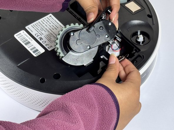

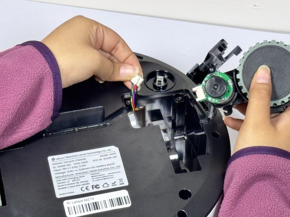

  3. Lefant M210 Battery Replacement, Wheel Assembly: crwdns2935265:04crwdnd2935265:01crwdnd2935265:01crwdne2935265:0
    • Use a Phillips screwdriver to remove four screws near each wheel.
  4. Lefant M210 Battery Replacement: crwdns2935265:05crwdnd2935265:01crwdnd2935265:02crwdne2935265:0 Lefant M210 Battery Replacement: crwdns2935265:05crwdnd2935265:02crwdnd2935265:02crwdne2935265:0
    • Remove the plastic cover next to each wheel.
    • Grip both sides of the wheel and pull upwards.
    • The wheels of the device require some force to remove.
    • Don't pull the wheels too hard as they are attached to cables and may be damaged if yanked.
  5. Lefant M210 Battery Replacement: crwdns2935265:06crwdnd2935265:01crwdnd2935265:03crwdne2935265:0 Lefant M210 Battery Replacement: crwdns2935265:06crwdnd2935265:02crwdnd2935265:03crwdne2935265:0 Lefant M210 Battery Replacement: crwdns2935265:06crwdnd2935265:03crwdnd2935265:03crwdne2935265:0
    • Hold the wheel up and detach the connector to release it from the device.

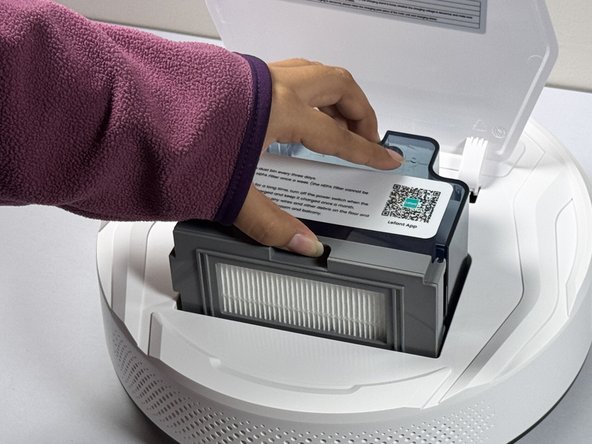

  6. Lefant M210 Battery Replacement, Dustbin Filters: crwdns2935265:07crwdnd2935265:01crwdnd2935265:01crwdne2935265:0
    • Open the dustbin compartment.
  7. Lefant M210 Battery Replacement: crwdns2935265:08crwdnd2935265:01crwdnd2935265:02crwdne2935265:0 Lefant M210 Battery Replacement: crwdns2935265:08crwdnd2935265:02crwdnd2935265:02crwdne2935265:0
    • With your hands, gently pull the dustbin to remove it from its compartment.
  8. Lefant M210 Battery Replacement: crwdns2935265:09crwdnd2935265:01crwdnd2935265:01crwdne2935265:0
    • With your hands, pull off the filter compartment from the dustbin.
  9. Lefant M210 Battery Replacement: crwdns2935265:010crwdnd2935265:01crwdnd2935265:01crwdne2935265:0
    • Pull off the filter from the filter compartment.

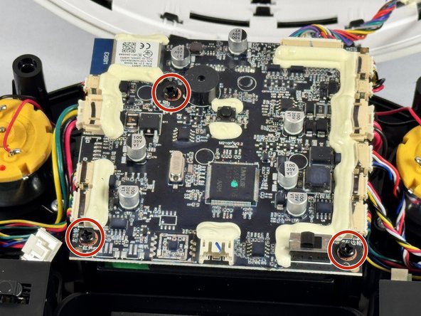

    • Use a Phillips #1 screwdriver to remove the three screws securing the motherboard to the device.

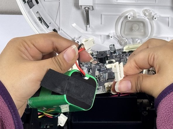

  13. Lefant M210 Battery Replacement: crwdns2935265:014crwdnd2935265:01crwdnd2935265:01crwdne2935265:0
    • Carefully lift the motherboard, ensuring you don't rip any cables that are connected to it.
    • The battery should be under the motherboard.
  14. Lefant M210 Battery Replacement: crwdns2935265:015crwdnd2935265:01crwdnd2935265:02crwdne2935265:0 Lefant M210 Battery Replacement: crwdns2935265:015crwdnd2935265:02crwdnd2935265:02crwdne2935265:0
    • Push the two retaining clips away from the battery while pulling the battery up from the tabs attached to it to free it.
    • Retaining clips
    • Battery tabs
    • Work on freeing one side at a time so that it's easier to free the battery.
  15. Lefant M210 Battery Replacement: crwdns2935265:016crwdnd2935265:01crwdnd2935265:01crwdne2935265:0
    • When the battery is free from it's housing, lift it out completely using its pull tabs.

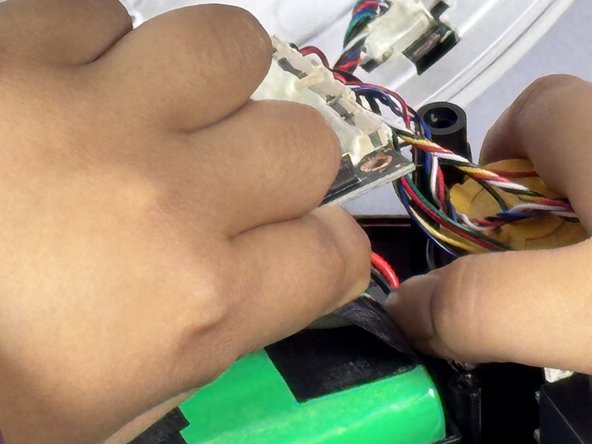

  16. Lefant M210 Battery Replacement: crwdns2935265:017crwdnd2935265:01crwdnd2935265:02crwdne2935265:0 Lefant M210 Battery Replacement: crwdns2935265:017crwdnd2935265:02crwdnd2935265:02crwdne2935265:0
    • Locate the battery connection wire and carefully pull apart the connection.
    • Pinch the motherboard's wire connector and pull the connection apart.
    • The connection is secured by a clothespin-like mechanism.
    • When you replace your battery with a new one, allow the robot vacuum to fully charge for a few hours before using it again.

As for those that stumble upon this, mind that ******if you only want to access the battery, steps 10 to 16 are the only on you need.
Sylvain “Neoblasphem” Mourot - crwdns2934203:0crwdne2934203:0
