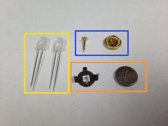

  2. Learn to solder electronics with the Maker Shed Solder Badge!, Get acquainted with the contents in your Learn to Solder kit: crwdns2935265:04crwdnd2935265:01crwdnd2935265:03crwdne2935265:0 Learn to solder electronics with the Maker Shed Solder Badge!, Get acquainted with the contents in your Learn to Solder kit: crwdns2935265:04crwdnd2935265:02crwdnd2935265:03crwdne2935265:0 Learn to solder electronics with the Maker Shed Solder Badge!, Get acquainted with the contents in your Learn to Solder kit: crwdns2935265:04crwdnd2935265:03crwdnd2935265:03crwdne2935265:0
    • Printed Circuit Board (PCB)
    • Pinhole
    • LED spots
    • Battery pad
    • Pin and its backing
    • RGB LED (2)
    • Battery holder and CR 1220 Lithium battery

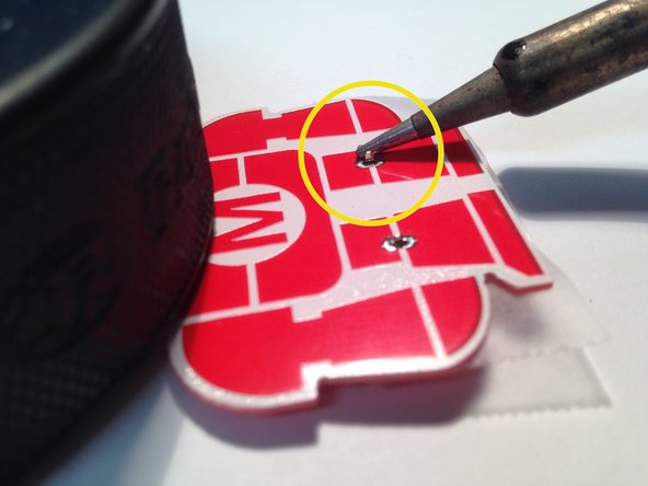

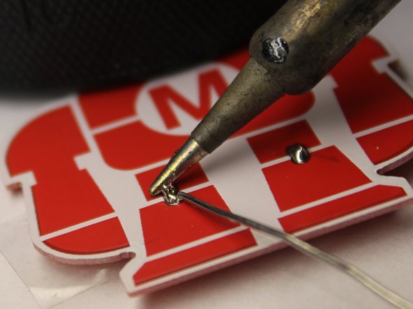

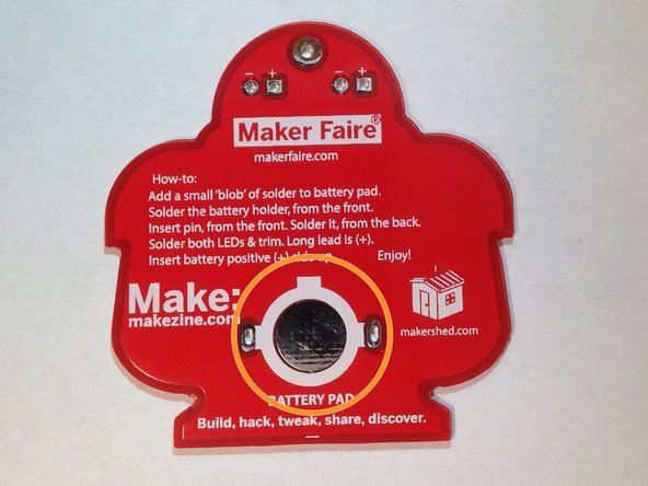

  4. Learn to solder electronics with the Maker Shed Solder Badge!, First melts: crwdns2935265:08crwdnd2935265:01crwdnd2935265:03crwdne2935265:0 Learn to solder electronics with the Maker Shed Solder Badge!, First melts: crwdns2935265:08crwdnd2935265:02crwdnd2935265:03crwdne2935265:0 Learn to solder electronics with the Maker Shed Solder Badge!, First melts: crwdns2935265:08crwdnd2935265:03crwdnd2935265:03crwdne2935265:0
    • Rest the soldering iron on the battery pad to heat it up.
    • Once the pad is hot enough, begin adding solder.
    • If solder does not flow immediately when it comes in contact with the pad, remove it and allow the pad to heat up longer.
    • Apply a large gob of solder to the pad (as shown).
    • Tin the iron and return it to its stand.

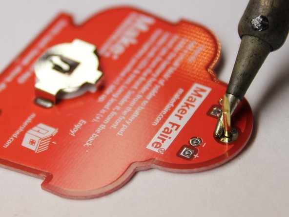

  7. Learn to solder electronics with the Maker Shed Solder Badge!, Solder the battery holder: crwdns2935265:011crwdnd2935265:01crwdnd2935265:02crwdne2935265:0 Learn to solder electronics with the Maker Shed Solder Badge!, Solder the battery holder: crwdns2935265:011crwdnd2935265:02crwdnd2935265:02crwdne2935265:0
    • Place a heavy object on the board to keep it from sliding around on the table.
    • Rest the iron between the extruding battery holder tab and the corresponding solder pad to begin heating them up.
    • The junction will not heat up immediately. It is necessary to hold the iron in place for about 20-30 seconds before sufficiently hot.
    • Applying pressure to the junction, as opposed to simply laying the iron, will improve heat conductivity. This will speed up the process and result in a better solder joint.
  8. Learn to solder electronics with the Maker Shed Solder Badge!, asdf: crwdns2935265:012crwdnd2935265:01crwdnd2935265:03crwdne2935265:0 Learn to solder electronics with the Maker Shed Solder Badge!, asdf: crwdns2935265:012crwdnd2935265:02crwdnd2935265:03crwdne2935265:0 Learn to solder electronics with the Maker Shed Solder Badge!, asdf: crwdns2935265:012crwdnd2935265:03crwdnd2935265:03crwdne2935265:0
    • Check if the junction is hot enough. Without removing the iron, begin feeding solder into the junction between the tab and the pad. If the iron is on one side of the tab, feed the solder from the other side (as depicted).
    • Applying solder directly to the iron may appear sufficient, but will result in a cold joint. Always apply solder to a junction, not directly to the iron.
    • Smoke is a normal occurrence, and is safe to breath (but obviously not in a prolonged setting). The smoke is due to the rosin flux core burning off. It contains no additional toxins.
    • If solder melts immediately upon contact, the junction is hot enough!
    • If solder only partially melts, or does not melt at all, more time is required to heat up the junction.
    • Apply a generous amount of solder to the junction. The resulting solder joint should be shiny and appear as shown. If this is not the case, lay the iron back on the pad and reflow the joint until the solder liquifies again.

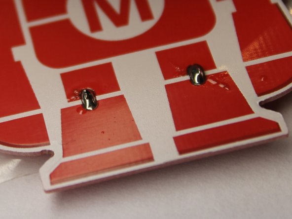

  10. Learn to solder electronics with the Maker Shed Solder Badge!, Identify and fix any cold solder joints: crwdns2935265:014crwdnd2935265:01crwdnd2935265:03crwdne2935265:0 Learn to solder electronics with the Maker Shed Solder Badge!, Identify and fix any cold solder joints: crwdns2935265:014crwdnd2935265:02crwdnd2935265:03crwdne2935265:0 Learn to solder electronics with the Maker Shed Solder Badge!, Identify and fix any cold solder joints: crwdns2935265:014crwdnd2935265:03crwdnd2935265:03crwdne2935265:0
    • Cold solder joints, or "crappy" solder joints, aren't electrically or structurally stable. If a joint doesn't appear perfect, it's probably cold. Reflow the joint by applying the iron and allowing the solder to flow through the junction again.
    • Cold solder joint
    • Same joint, reflowed for perfection
    • If ever a joint seems out of luck, feel free to start over. Use the solder sucker to remove the solder in the joint, then reheat the junction and re-add the solder.

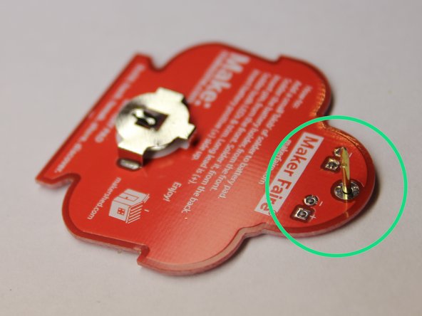

  11. Learn to solder electronics with the Maker Shed Solder Badge!, Position the pin: crwdns2935265:015crwdnd2935265:01crwdnd2935265:03crwdne2935265:0 Learn to solder electronics with the Maker Shed Solder Badge!, Position the pin: crwdns2935265:015crwdnd2935265:02crwdnd2935265:03crwdne2935265:0 Learn to solder electronics with the Maker Shed Solder Badge!, Position the pin: crwdns2935265:015crwdnd2935265:03crwdnd2935265:03crwdne2935265:0
    • Insert the pin from the front of the board.
    • Place the board on the table so the pin is pointing upwards, as depicted.
    • Begin heating the junction between the pin and the pad.
  12. Learn to solder electronics with the Maker Shed Solder Badge!, Solder the pin: crwdns2935265:016crwdnd2935265:01crwdnd2935265:03crwdne2935265:0 Learn to solder electronics with the Maker Shed Solder Badge!, Solder the pin: crwdns2935265:016crwdnd2935265:02crwdnd2935265:03crwdne2935265:0 Learn to solder electronics with the Maker Shed Solder Badge!, Solder the pin: crwdns2935265:016crwdnd2935265:03crwdnd2935265:03crwdne2935265:0
    • Continue heating the junction by positioning the iron as previously instructed.
    • The material in this junction is sufficiently greater in mass than the battery holder, thus it will require more heat to raise it to the correct temperature. Leave the iron in place a little longer than previously, and check how well solder flows when you begin.
    • Feed solder into the junction.
    • Check for a cold solder joint. Reflow if necessary.
    • Tin the tip of the iron and return the iron to its stand.

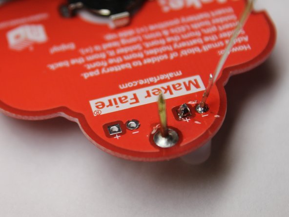

  14. Learn to solder electronics with the Maker Shed Solder Badge!, Solder the LEDs: crwdns2935265:018crwdnd2935265:01crwdnd2935265:03crwdne2935265:0 Learn to solder electronics with the Maker Shed Solder Badge!, Solder the LEDs: crwdns2935265:018crwdnd2935265:02crwdnd2935265:03crwdne2935265:0 Learn to solder electronics with the Maker Shed Solder Badge!, Solder the LEDs: crwdns2935265:018crwdnd2935265:03crwdnd2935265:03crwdne2935265:0
    • It does not mater which lead of the LED you begin soldering.
    • Begin heating up the junction between an LED lead and its pad by pressing the iron into the junction as illustrated.
    • Once the junction is hot enough, add solder until the joint is strong enough.
    • Tin the iron tip, then return it to its stand.

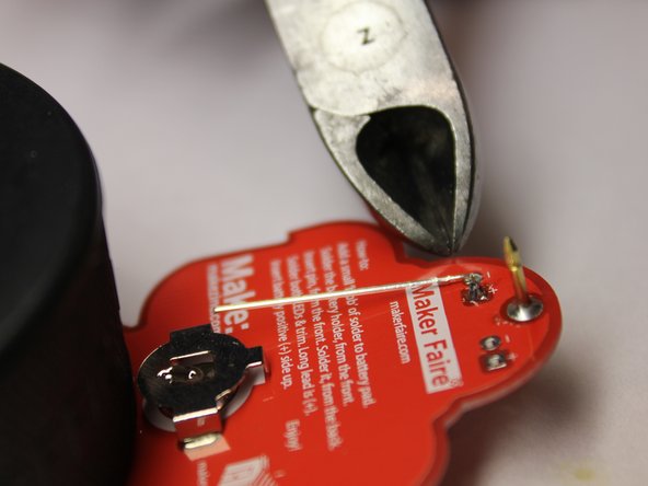

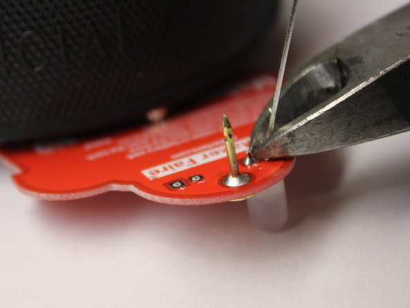

  15. Learn to solder electronics with the Maker Shed Solder Badge!: crwdns2935265:019crwdnd2935265:01crwdnd2935265:02crwdne2935265:0 Learn to solder electronics with the Maker Shed Solder Badge!: crwdns2935265:019crwdnd2935265:02crwdnd2935265:02crwdne2935265:0
    • Only cut off leads that you have already soldered in place.
    • Use diagonal cutters to clip off the excess leads on the LED.
    • Cut as far to the solder join as you can.
  16. Learn to solder electronics with the Maker Shed Solder Badge!, Continue soldering the LED in place.: crwdns2935265:020crwdnd2935265:01crwdnd2935265:03crwdne2935265:0 Learn to solder electronics with the Maker Shed Solder Badge!, Continue soldering the LED in place.: crwdns2935265:020crwdnd2935265:02crwdnd2935265:03crwdne2935265:0 Learn to solder electronics with the Maker Shed Solder Badge!, Continue soldering the LED in place.: crwdns2935265:020crwdnd2935265:03crwdnd2935265:03crwdne2935265:0
    • Bend up the second lead and begin to heat it.
    • When sufficiently hot, apply solder to secure the joint.
    • Tin the tip of the iron, then return it to its stand.
    • Cut the lead off when you're finished.

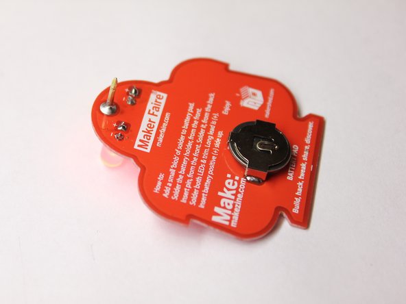

  18. Learn to solder electronics with the Maker Shed Solder Badge!, Install the battery: crwdns2935265:022crwdnd2935265:01crwdnd2935265:02crwdne2935265:0 Learn to solder electronics with the Maker Shed Solder Badge!, Install the battery: crwdns2935265:022crwdnd2935265:02crwdnd2935265:02crwdne2935265:0
    • Slide the battery into the battery holder on the badge. One side of the battery has text -- this side should be facing up (away from the PCB) as illustrated.
    • If the LEDs do not light up, chances are the battery was inserted upside down. Don't fret! The electronics are fine! Just flip the battery around and it should work.
