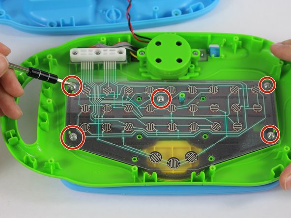

    3. Leapfrog My Own Leaptop Keyboard Buttons Replacement Guide: crwdns2935265:06crwdnd2935265:01crwdnd2935265:02crwdne2935265:0 Leapfrog My Own Leaptop Keyboard Buttons Replacement Guide: crwdns2935265:06crwdnd2935265:02crwdnd2935265:02crwdne2935265:0
      • Remove the three 10mm screws from the upper left hand corner white plastic piece with a PH1 phillips head screwdriver.
      • Unscrew the five 4mm screws from the plastic membrane with a PH1 phillips head screwdriver.

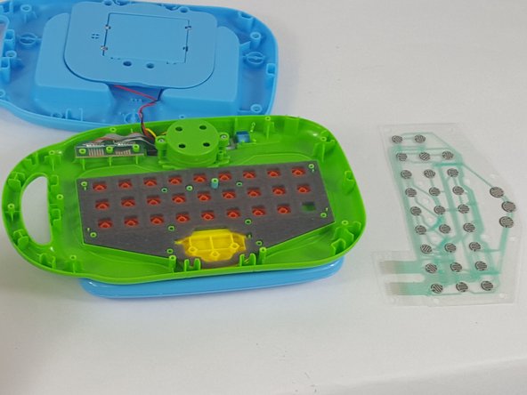

    4. Leapfrog My Own Leaptop Keyboard Buttons Replacement Guide: crwdns2935265:07crwdnd2935265:01crwdnd2935265:01crwdne2935265:0
      • Remove the white plastic piece and place it to the side.

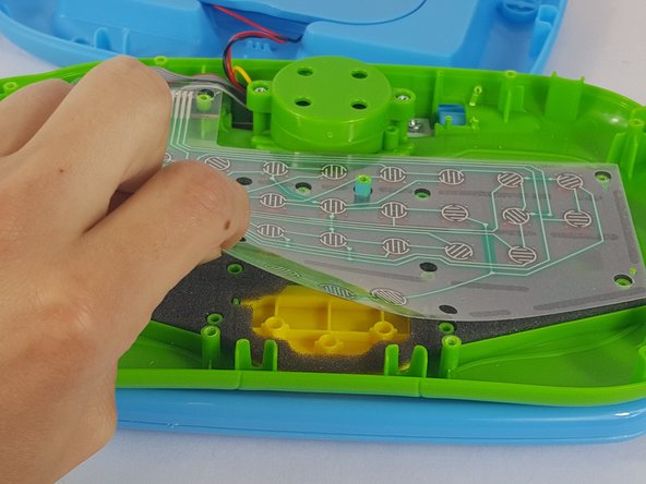

    5. Leapfrog My Own Leaptop Keyboard Buttons Replacement Guide: crwdns2935265:08crwdnd2935265:01crwdnd2935265:03crwdne2935265:0 Leapfrog My Own Leaptop Keyboard Buttons Replacement Guide: crwdns2935265:08crwdnd2935265:02crwdnd2935265:03crwdne2935265:0 Leapfrog My Own Leaptop Keyboard Buttons Replacement Guide: crwdns2935265:08crwdnd2935265:03crwdnd2935265:03crwdne2935265:0
      • Gently grab the membrane and peel it upwards.
      • Carefully remove the membrane and set it to the side.
      • From this step you can also clean the membrane of any residue with a lightly dampened paper towel.
      • Ensure that the membrane is completely dry before reassembly.
    6. Leapfrog My Own Leaptop Keyboard Buttons Replacement Guide: crwdns2935265:09crwdnd2935265:01crwdnd2935265:02crwdne2935265:0 Leapfrog My Own Leaptop Keyboard Buttons Replacement Guide: crwdns2935265:09crwdnd2935265:02crwdnd2935265:02crwdne2935265:0
      • Gently lift and remove the foam piece

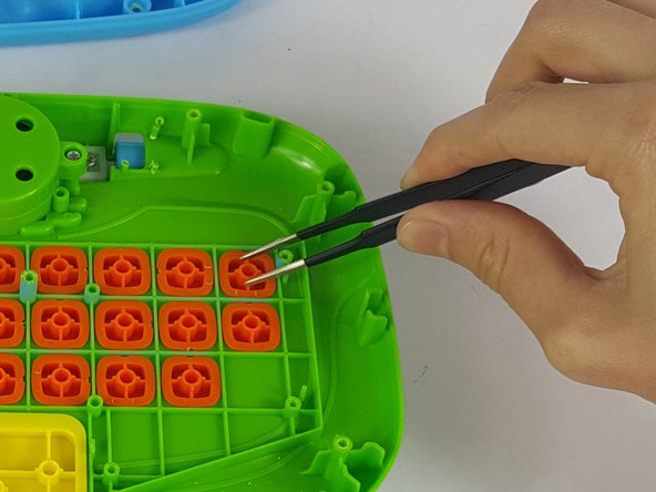

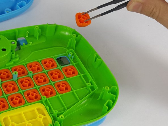

    7. Leapfrog My Own Leaptop Keyboard Buttons Replacement Guide: crwdns2935265:010crwdnd2935265:01crwdnd2935265:03crwdne2935265:0 Leapfrog My Own Leaptop Keyboard Buttons Replacement Guide: crwdns2935265:010crwdnd2935265:02crwdnd2935265:03crwdne2935265:0 Leapfrog My Own Leaptop Keyboard Buttons Replacement Guide: crwdns2935265:010crwdnd2935265:03crwdnd2935265:03crwdne2935265:0
      • From here, each button is able to be removed for cleaning or replacement.
      • Using a tweezers or needle nose pliers, remove the necessary pieces from the device.
