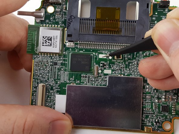

  10. Leapfrog LeapPad 3 Rear Facing Camera Replacement, Rear Facing Camera: crwdns2935265:010crwdnd2935265:01crwdnd2935265:02crwdne2935265:0 Leapfrog LeapPad 3 Rear Facing Camera Replacement, Rear Facing Camera: crwdns2935265:010crwdnd2935265:02crwdnd2935265:02crwdne2935265:0
    • Unplug the rear facing camera located in the top center of the motherboard.
  11. Leapfrog LeapPad 3 Rear Facing Camera Replacement: crwdns2935265:011crwdnd2935265:01crwdnd2935265:03crwdne2935265:0 Leapfrog LeapPad 3 Rear Facing Camera Replacement: crwdns2935265:011crwdnd2935265:02crwdnd2935265:03crwdne2935265:0 Leapfrog LeapPad 3 Rear Facing Camera Replacement: crwdns2935265:011crwdnd2935265:03crwdnd2935265:03crwdne2935265:0
    • Unhook the small plastic tooth from the underside of the motherboard. This can be accomplished with tweezers.

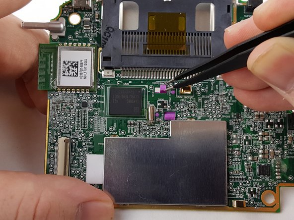

  12. Leapfrog LeapPad 3 Rear Facing Camera Replacement: crwdns2935265:012crwdnd2935265:01crwdnd2935265:02crwdne2935265:0 Leapfrog LeapPad 3 Rear Facing Camera Replacement: crwdns2935265:012crwdnd2935265:02crwdnd2935265:02crwdne2935265:0
    • Pull the camera out of the top of the motherboard for replacement.
